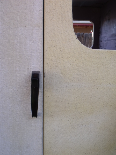

My doors turned out pretty good. There are a few things to be aware of though.
My first issue is that I did not allow enough space for a thicker gasket in the threshold width. I figured on a gasket, just not a thick enough gasket to be able to seal against all the irregularities with the door and door frame. The thin gasket does not have enough reach to seal properly and a thicker gasket pushes the door out too far. I am thinking, in my case, I may have to make two new doors that are 1/4"-1/2" thinner to allow for a thicker gasket. The other option is to rebuild the threshold, but that would be a lot more work. Doors are easy.
The second issue is heat expansion. I installed my first door in the morning. I allowed a 1/8" clearance for the threshold clearance. Worked great until the sun came out and warmed everything up! Once warm the door catches on the lower bottom of the threshold. Not real bad, but enough to make me want to make another door to fix the problem. If the doors where not so thick (2") I think this would not be a issue. When I installed the second door I allowed for 1/4" clearance for the threshold. No problems there yet. I would recommend when installing your doors that you make your cuts and measurements when everything is nice and warm. That way expansion is nearly maxed out and you do not need to worry about whether you allowed enough clearances.
