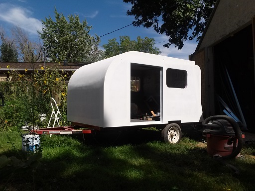

I did paint the entire trailer with Gripper. I used it to make sure all looked like if faired out OK. Plus I did need it for the TBII to stick to the areas with flashing/beading. With the trailer all one color and texture I could see blemishes easier. I don't think you have to paint the whole trailer though if you don't want to.
painted
George.
