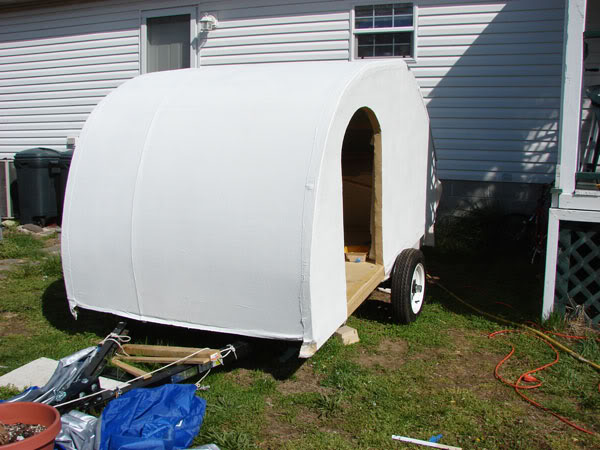

Postby GPW » Thu Apr 13, 2017 6:05 am
Rusty , as we recall Louella (Eagle ) originally covered her Foamie trailer ( which I think is the first one built here after the discussion started. ) with HF canvas and positioned her seams to run along the roof , and it looked good ... Seams are not so bad , it’s Where you put em' ...
Re: Harbor freight Canvas..seams
Postby GPW » Thu Apr 13, 2017 6:34 am
Went back in the Big thread (page 48) and found ths pic ... 2011
Postby ghcoe » Thu Apr 13, 2017 7:05 am
GPW wrote:Went back in the Big thread (page 48) and found ths pic ... 2011
Looks like a racing stripe! :thumbsup:

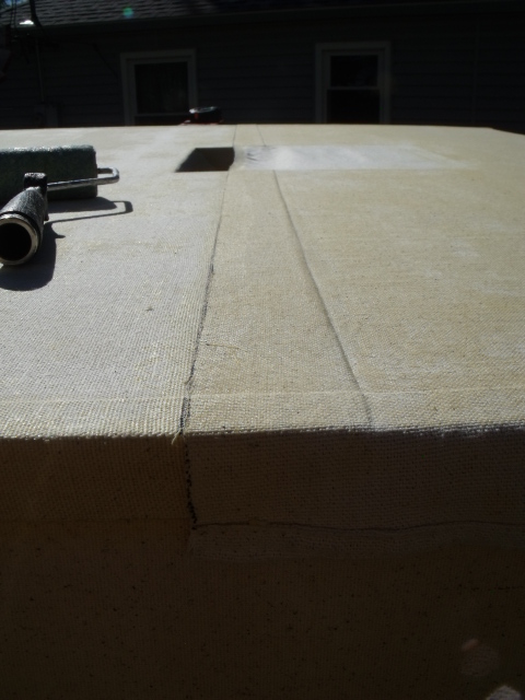

Postby Pmullen503 » Thu Apr 13, 2017 7:20 am
I made my seams by butting two pieces edge to edge and then placing a 4 inch wide strip over the seam. Flatter than the sewn seam and I made sure it was straight, right down the center of the roof. It looks OK.
If I had it to do over I would have bought more wide canvas. That would have added only a few percent to the total cost of the trailer.

Postby ghcoe » Thu Apr 13, 2017 1:14 pm
I guess it depends on how big a seam you want. If interested I showed how to do a seam, I did it twice on my roof/front canvas since the canvas was too short to make a full run. The info is nearly half way down here. http://tnttt.com/viewtopic.php?f=55&t=5 ... m#p1146811.
Seam
George.
