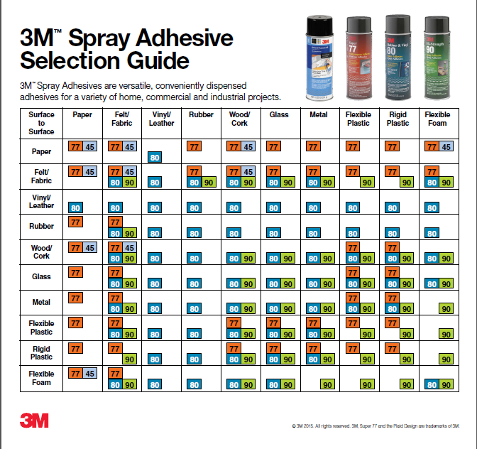

    I've used different 3M adhesive sprays over the years, but my go-to was always Super 77. From putting a headliner in my Chevelle, to gluing paper labels on hundreds of thousands of plastic-shrink-wrapped pallets (I ran receiving dept. for a major metropolitan newspaper-sorta like Clark Kent, aka S.......), I did both, using Super 77. The headliner is still up, after 21 years, and I presume my successor at work still uses Super 77, also. I think it'll work for you, in this case, as would the 8090. Here's the 3M recommendation-for-usage chart:
    3M Adhesive chart1.PNG (122.28 KiB) Viewed 734 times
    the fabric-to-foam recommendation is 77, 80, 90
