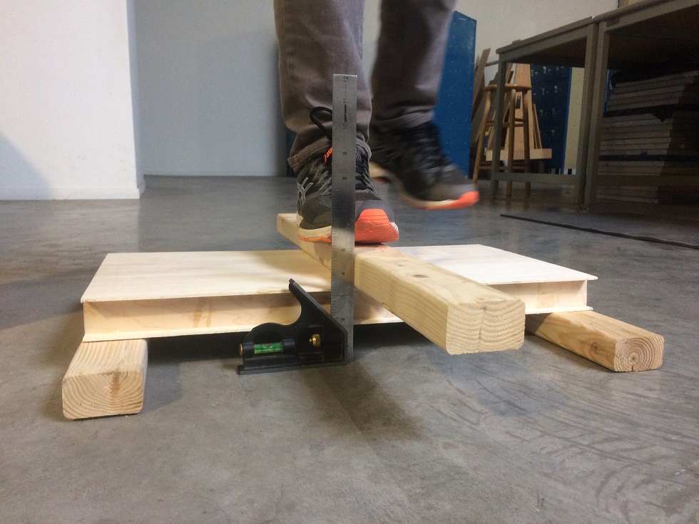

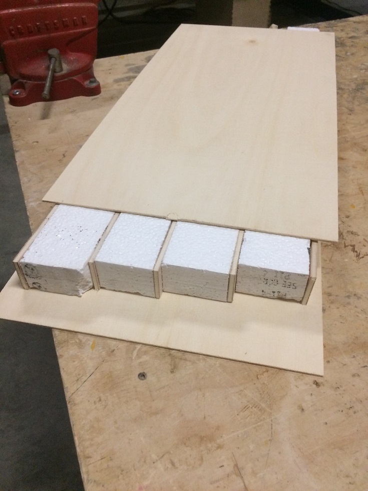

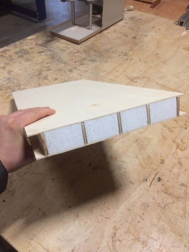

I just finished a little experiment using 1.5" EPS.
I used GG to hastily glue together a "beam" using 1/8" ply skins, 1/4" ply stringers and 1.5" EPS filler.
After I glued it up I trimmed the ends flush. The beam is about 11" x 2" x 24"
then I STOMPED on it. I got a friend to stomp on it with me. It took our combined 400 pounds seesawing/bouncing on the 2x3 to get it to crack. :wine:
I am interested in building SIPs, but with a torsion box frame, similar to these singcore panels http://singcore.com/product/sing-panels.
