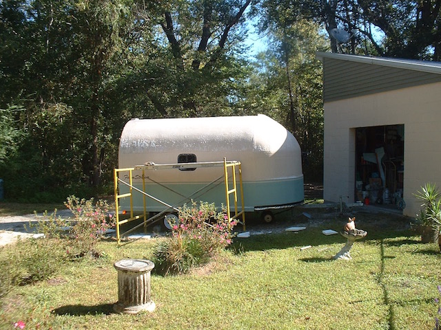

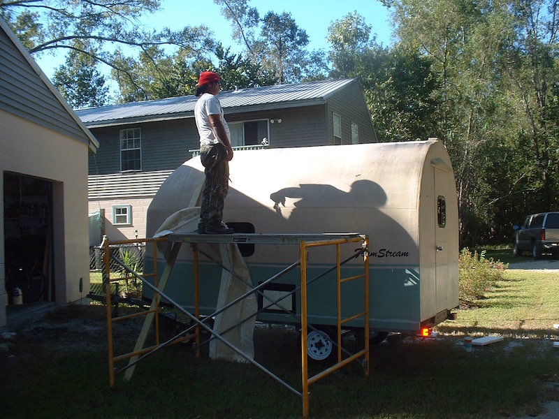

Postby GPW » Wed May 17, 2017 4:09 pm
We had to scaffold up for ours...

Re: Applying canvas to roof of tall foamie
Postby GPW » Thu May 18, 2017 5:08 am
Rusty , guessing our overall height is ~ 8 feet … ( we’ll have to measure when it gets light ) We tried the old ladder , but it was too shakey for me ( old guy) Scaffolds worked fine … :thumbsup:
