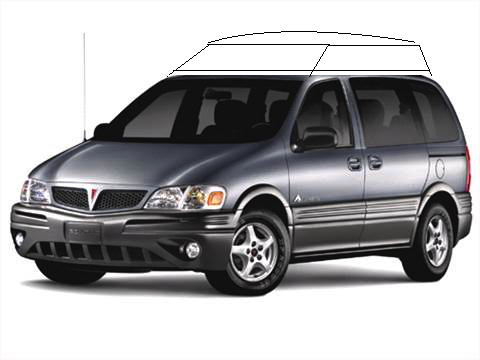

I'm looking at making a bid on a cargo van delivery contract that my van just falls short on the storage space requirements. The hit on the initial cost and ongoing fuel economy to upgrade to a full size van would be pretty painful. Am I crazy to want to try this? I've had a look up close at a GMC safari someone built a plywood camper topper for and there didn't seem to be to much too it. With fiberglass cargo toppers costing nearly $3000 and my van (2009 pontiac montana SV6) being a shorter size than most toppers I could hope to find at a scrap yard. I'd be using it exclusively for the added cargo/standing room so I would probably cut the van roof a foot or so back from the drivers seat and use that portion of the roof as a storage cubby and have the added structural strength in case of a roll over.
:thumbsup: :thumbdown: Any thoughts or advice? Stick with a commercial solution, go for something heavier or it will work just fine?

Something like this ?

I would recommend a tiny trailer instead. One that is shorter and less wide than the van and not very long. That way you get no wind resistance from it and do not take a fuel economy hit. Making the roof of your van taller will impact your gas milage, be a lot of work, reduce resale value and you risk water leaks onto your packages.
With a small trailer you could look for one thats super easy to get into or just load all your packages for the last bit of your trip into it. Then when you finish whats in the van you could quickly throw everything from the trailer into the van.
Something 4ft wide and less than 5ft tall im thinkin. Probably smaller than these.
As long as their several inches narrower than the van and several inches shorter you will not notice much of a fuel economy hit.

X2 on the trailer, more flexible, fewer issues long term

unless you have to back up, then you wont be so happy with a little trailer

GPW wrote:Something like this ?
Yes that exactly.

I recommend full screens for the front windows. Either a Sceeter beater (slip over style) or sew strip magnets into a pocket around the edges of screen material to the profile of the doors For the back, we have blackout curtains made from reflect-tex with black fabric on the outside and a nice print on the inside and a 4 inch boarder of screen to fill in the gap on those tilting back windows. They stay in place just fine without any fasteners. Also a reflect-tex cover for the back window. We've slept warm and comfortable down to 25. But not enough airflow if the temps stay above about 60 at night. I'm trying to design something for screens on the sliding doors.
I wouldn't cut into the roof as I'd be concerned about the structural integrity of the vehicle. I'd look into one of those SUV tents that connects to the van to get standing space. But we generally only camp for 1 or 2 nights at a time, so we've not had anything for 4 years. I'm looking forward to having the popup changing tent this year.
