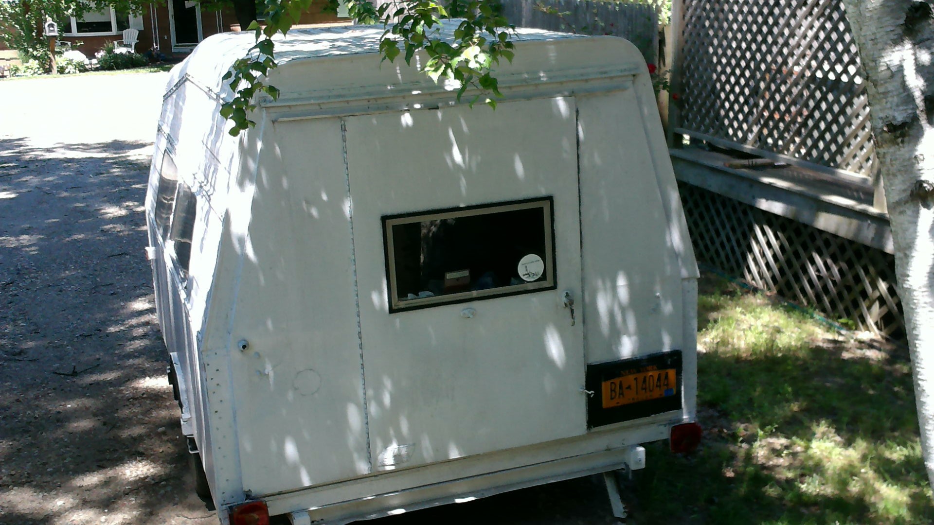

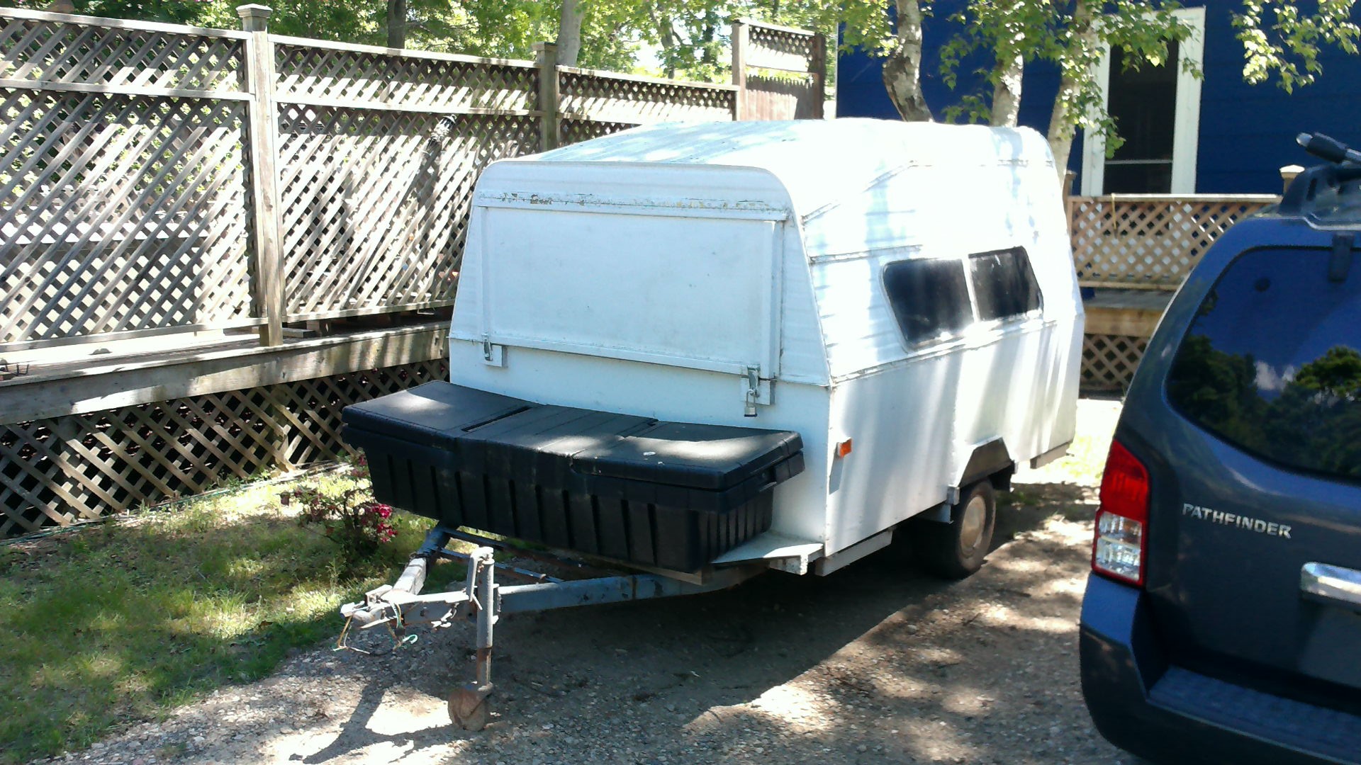

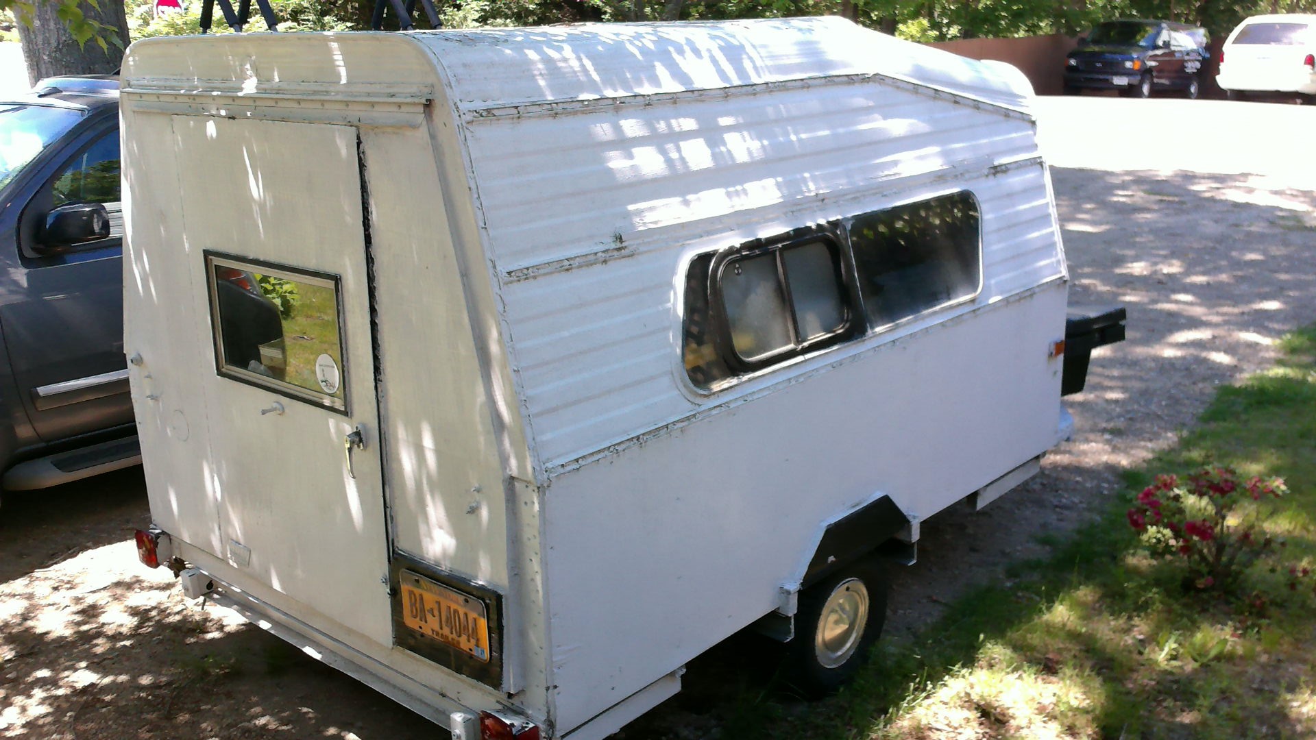

I want to make something that I can bring with me but NOT on a trailer (I already have a TTT) that I can setup on the ground when camping and provides a room that I can stand up in and do stuff in (cook, eat, lounge, get out of the weather, etc...) when I'm not sleeping in my TTT. My TTT is an old build thread on here somewhere and is an old pop-up's trailer-only with a truck-bed-camp cap that I built a wooden truck bed to mate it to the trailer. You can't stand up in it and it is not a place to be unless you are sleeping.

I will post a current pic of the TTT as soon as I remember how on here again.
