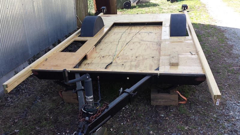

Camper floor progressing.jpg (243.44 KiB) Viewed 1142 times
A pic of what I did

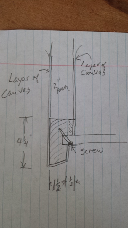

Postby Don L. » Sun Jun 11, 2017 8:07 am

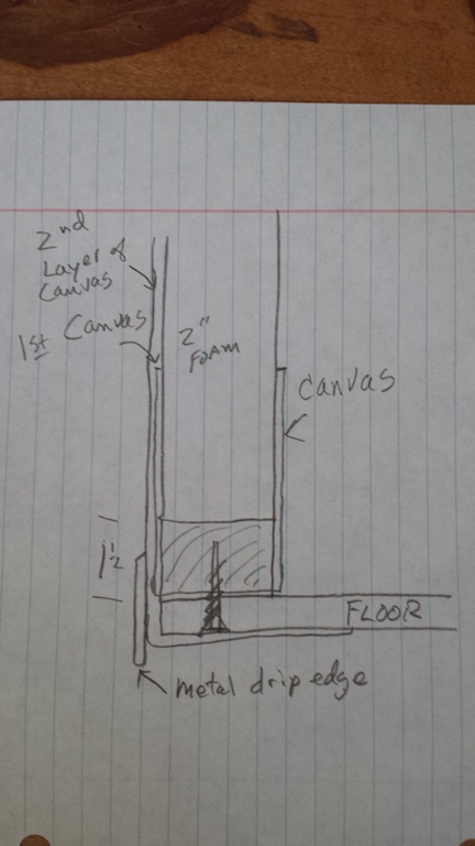

Pic of what I did, angled the lower edge to make water drip off efficiently

An easier method, less milling of wood.
Easier floor.jpg (112.27 KiB) Viewed 1136 times
On this method, glue a 2" rip of 1-1/2" board to the foam edge, wrap with canvas (glued) about 8"up the wall. Then screw it to the floor. Then wrap the final wall covering over that joint and under the floor.
A drip edge is important.
On the underside of my floor I rolled on a coat of aluminum/asphalt roof paint before I put on the walls, , I doubt titebond 2 would stick to that so maybe stop the asphalt paint short of the edge so your glue will adhere the canvas well. Maybe then go over that with asphalt. Just some ideas...
