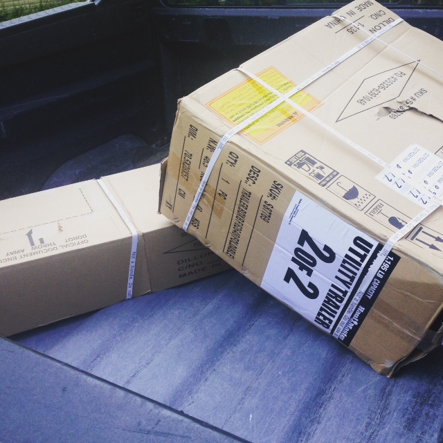

Postby amandacreiglow » Thu Jun 15, 2017 3:23 pm
Thanks for the welcome, guys! Was able to get the truck to head out to Harbor Freight today and grab the Trailer. Wasn't expecting it to be in two boxes, but in retrospect that makes perfect sense.
Time to get my ikea-skills on. :D

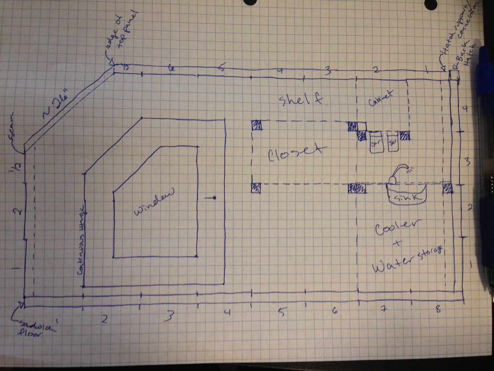

Drew up a quick first sketch of what I'm thinking as far as where everything goes. It's pen and paper, and definitely the lowest-tech thing I've seen on here. :R It's also a bit approximate, as getting down to exact inches would be tricky at this point. But here it is:
The little boxes are 2x2's run across the width of the trailer. The dashed lines are generally 1/4" ply used for shelving, other than the countertop which will be 1/2". I haven't shown it here to try and keep it uncluttered, but there will be a frame for both the inside and outside of the door also out of the same 2x2's.

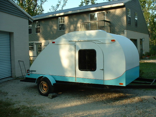

Postby GPW » Tue Jul 04, 2017 5:09 am
Make the door the way YOU want to…. The only thing a "suicide “ door needs is a good latch , and conscientious owner … ;)
