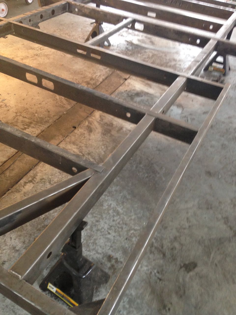

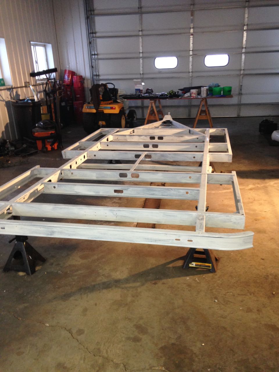

Postby Bruue1 » Tue Feb 27, 2018 10:34 pm

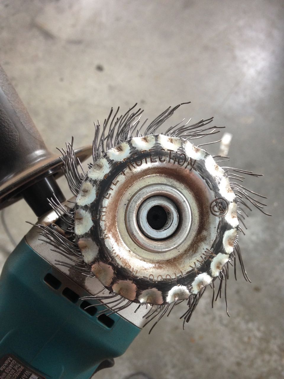

Here are some pictures of the frame prep. I think something is wrong with my wire brush wheel in the middle picture... :shock: :?
So my next step with this is to weld some raw receiver stock into the frame, I want the receiver to protrude through the rear bumper. ( for the bike carrier, rather than build some huge custom bike older I figured a 2 inch receiver would be more versatile)
I've only done very minimal welding and it was all with an eighties vintage Craftsman/Sears 115v AC buzz box I got fro free from a friend who got it free from his neighbor etc...
Just today I ordered a Amico160amp DC Inverter off of Amazon for $170. It got great reviews. I'm hoping to get practiced up once it gets here and to make some passable welds to attach this 2 inch receiver hitch to the trailer.
I know to clean the metal and use 6011 and 7018 rod for almost everything... any welding advice beyond that would be greatly appreciated. I should be welding this Fri/Sat if Amazon delivers on time.

Postby Bruue1 » Wed Feb 28, 2018 5:23 pm
I got a lot done today. I included three pics with this post, the beginning, the fab work and the end of my 6 hour day. I'm sure someone with more experience could have done it much quicker. I think today brings my total hours of labor on this project to 20.
So I got some receiver stock off of Amazon, it came in a box with a CURT logo on it. The total price was $60, free shipping. It is raw steel, 48 inches long, there is a collar on the end and the pin holes are already drilled through it. I did put a hitch in it just to be sure, yes it did fit just like it should.
I fabbed up a plate and some brackets with rusty scrap that had originally been bolted onto the pop up camper. Now it is a set of clean install brackets for this hitch.
Everything is clean and ready to weld. Hopefully my little Amico 160amp DC welder will arrive on time from Amazon and this will be welded together by the end of the weekend. Then we can prime, paint and figure out the floor. :thumbsup:

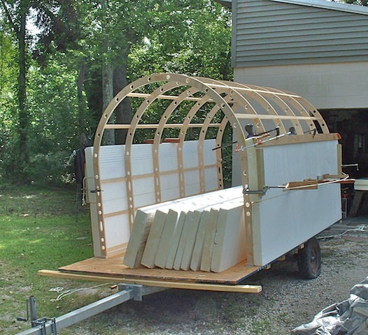

You know , if you give your locations , members could help each other with parts if locally close together… :thinking: And you could arange to Help each other with builds …
Bru’, a simple frame Plus foam walls makes a very strong structure...

Bru , After 4 years living Outside , we’re still in tip top shape , no leaks and no rot, no delamination … :thumbsup: This was my second Foamie … Bigger ,more comfortable for the wife … The door works great , no leaks and it’s so tight , it whistles when you close it … :o
Since we have this for EVAC , we must depend on it every year … Why we built a foamie as nothing else lasted as well living outside , uncovered…  ;)
We even tried a Jayco , and it didn’t even make it through the warranty period without leaking and rotting …despite the friendly assurances of the Dealer that it would be just fine … :roll:
