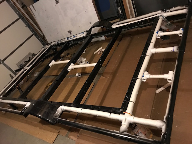

About the PVC framing. I used 1.5" schedule 40 PVC that is bolted to the sides of the rails--front, back and sides. On the sides it extends the with of the fenders (8 inches) and rests on the fender supports. In addition to the carriage bolts, I have 25 steel cable ties to wrap around the steel frame and the PVC pipe. On the front I will also have a 3 ft piece of c-channel to tie into the cross pieces of the tow rail to lend additional support. On top of the PVC and steel frame is 1" foam with the underside reinforced with gripper and fiberglass screening. Glued to the top of the foam is 1/2" plywood with holes drilled and countersunk for the bolts. On top of that will be 1/8" plywood and stick-on linoleum in walking areas.

Postby Jana » Mon May 07, 2018 10:03 pm
I think I finally figured out posting pictures! Framing...Jana

Postby Pmullen503 » Tue May 08, 2018 9:02 am
I'm a little concerned about the frame/floor system. The PVC frame extensions will carry the weight of the walls and ceiling. The 1/2" floor/foam will add little rigidity by itself and the foam underneath will compress over time loosening your mounting bolts. Could you stand on the PVC perimeter and bounce on it without it failing or flexing?
If you are committed to using the PVC frame extensions then the floor should be much stiffer.

Postby Jana » Tue May 08, 2018 8:33 pm
Thanks! I really appreciate your comments. The PVC can take my weight without flexing or collapsing. I think we will make some modifications to further beef up support. In the area by the door we had put 10" carriage bolts through the steel frame and both PVC pipes to add extra support.This made it rock solid. I think we will will switch to 10" bolts on all of the 8" side areas. I think we will add either another 1/2" or 3/8" layer of plywood to the floor. Compression on the floor over time does concern me but I don't think we can redo that at this point. We do plan on gluing all the layers of the floor together and gluing the foam to the frame as well. Don't know if that will help. May have to figure out a way of putting in spacers underneath if that becomes a problem down the road.

Postby pchast » Tue May 08, 2018 9:03 pm
I would recommend using crush proof blocking wherever you plan bolting
to the frame.

Postby GPW » Wed May 09, 2018 6:58 am
Gosh , I don’t know about that trailer frame extension :NC … PVC is funny stuff , it can be brittle , or very flexible , or in between … ( we make bows out of it , and test it first ) But I don’t think I’d make a perimeter frame out of it … But what do I know ? Maybe just call this another “Test” , and see how it works out . Jana could be on to something … We never know the real TRUTH till somebody tests it …
And you may not know PVC gets Brittle in Cold temperatures , so for those folks that live up North ( above Baton Rouge :lol: ) You might want to use the thicker wall schedule 80, the gray PVC which has proven stronger …even at lower temps …

Postby KCStudly » Thu May 10, 2018 2:21 pm
Click the quote button to this post (no need to actually reply) to see how the coding looks when using the Img button to bracket the link to your picture.
I hope that PVC works out for you, as it is not really a structural material. Looks excessively complicated to my eye, but that is the beauty of these things; we each get to do it our own way! (... and I'm sure my way looks... nay IS, just as hard!)

Postby Jana » Sat May 12, 2018 7:06 am
So this is sounding like a really bad idea. :NC I need to ask worst case / likely scenario. My brother said he's seen a whole pile of PVC shatter--but that would be -20 in Wisconsin--which is not our typical temperatures. Could hitting one good bump do it in? :frightened: Does it get more brittle over time? Over time will it start sagging over the weight of the sides and roof? We could have done a wooden frame but this idea was just so clear in my mind. Innovation and experiments are good--but I don't want to be foolish about it either. At this point I am exploring how to proceed. I was also planning to shorten the back by 6" using repair couplers and I would use the 10 inch bolts all the way around except the front which is supported by c-channel. Will a 1" floor help? Do I consider a wooden frame on top using 2x2s? Dismantling it all? Do I wait and see what happens? Repairing this after the fact would probably be more difficult?

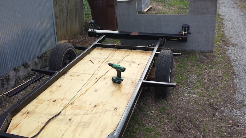

Postby Don L. » Sat May 12, 2018 6:29 pm
Itmight be good to reconsider the structure at this point, in my opinion. Remember the weight of the walls and roof and anything else attached to them will be weighing down onto the pvc.
Most trailer frames will have a little metal bracket piece extension welded to the main frame that stick out and support the outer walls. I'll try to show a pic of my frame.
Another thing that would support the walls would be a thicker wooden floor, at least 1-1/2" thick (2 layers of plywood or similar. That gets weighty though.
The bracket behind the wheel in this picture illustrate my point the best in this shot.

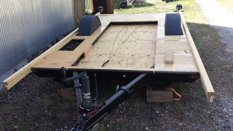

Postby Don L. » Sat May 12, 2018 6:42 pm
Here are a couple pics to show how I did mine. Not that that is the only way by any means. The wooden rail along the outside edges is what the walls rest on and spreads out the weigh of the wall and floor. It is left a little long in the pic, and was cut off to the proper length once I determined the where the wall ended.
I hope this all makes sense.
