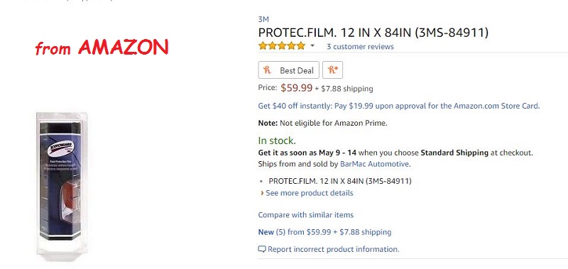

  • As to further side-wall protection (not necessary on my trailer, so far), I might recommend using diamond plate aluminum (if it gets dinged up, you could easily replace it, if screwed/bolted on), or 3M paint protective film. https://www.3m.com/3M/en_US/company-us/all-3m-products/N=5002385+8709313+8710654+8710859+8711017+8711731+8716713+8720073+8720123+3292322927&rt=rud
    3M protective film.JPG (67.33 KiB) Viewed 1540 times
    I have this on my 165k mile HHR Panel's rear fenders; it still looks good

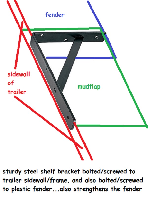

All is forgiven, then. And...dancam, have you considered using a shelf bracket, laid flat, and bolted to the trailer frame or body, on one leg, and to the plastic fender on the other leg. It would easily hold a mudflap, and also stabilize the fender. Just find one to fit your dimensions, or get one and alter it. Some are very strong, powder-coated against the weather, and very affordable. Just be sure to get a "No Step" sign to put there (ask me how I know).

Thanks for the ideas guys! Sorry i didnt reply earlier, its been lots of late nights working on this. I have some plans from your ideas, planning to pick up metal today and install new mudflaps saterday. I will post photos when i do it.
Shelf bracket was my first idea but i really dont like screwing things to my wooden frame, its only 2x2 and i would hate to have it split. Also it wouldnt look so nice and that top half of our trailer has to lift up, any more weight makes that heavier to lift...
Cant weld under the trailer because foam and my water tank is right in the way but i have a plan to bolt a bracket to the frame. Hope it works :/

Here is what i did. I didnt take good enough photos though. Hope you can see what i did well enough. I couldnt weld to the frame because of the pmf and my water tank but i bolted them to the old spring hanger (i moved the axle) and they shouldnt move.
