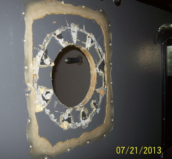

  • Though I didn't build a foamie, or use PMF, I did paint over the "mix", and also used plenty of Loctite PL Premium Adhesive on it, and can testify to paint/poly/PL all adhering well to it. I used the "mix" to soak into my exterior walls, then poly'd over that, then painted over all, before mounting vent covers (4) on them. When I had to remove and modify one vent, I had great difficulty in getting it off, cleanly, and actually lifted away 2 coats of the "mix", 2 coats of pure poly, then 2 more coats of acrylic enamel paint, as well as most of the outer ply of wood itself.
  • If the "mix" hadn't stuck/adhered to the outer ply so strongly, or the 4 coats of poly and paint, and the PL afterwards, then I would've easily removed the vent cover. I had expected to have at least one coat of coverings give up, before reaching the "mix" layers, but only found that the plies penetrated by it were joined forever together, to all layers bonded to it. I think the key to having all "bonding" so well together was that each coating was either oil-based, poly-based, or both....
    PL, over paint, over the mix- everything really sticks well.jpg (161.31 KiB) Viewed 1187 times
    once coated with the "mix', the plywood became inseparable from the outer coverings/coatings
