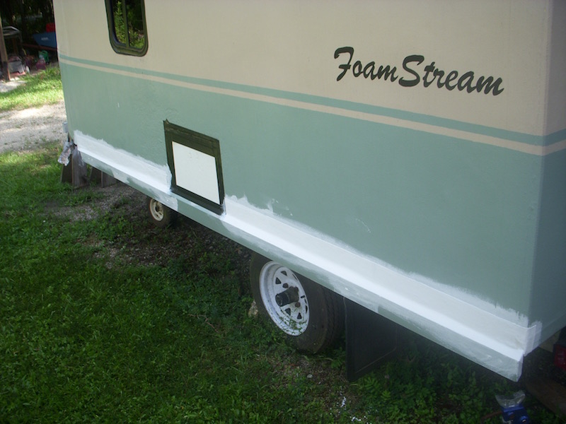

Finally got around to putting the canvas tape over the drip edges and ant holes … Not difficult to do and it “should “ keep the water running off the trailer to the ground …
However while feeling around underneath , we noticed water had already gotten in the ant holes and naturally that made my OSB floor soft … :o :shock: :frightened: So now we’re going to have to go in and remove the old floor and put in a completely new one … :NC Or at least do some serious repairs …
And you might ask , how did this happen … Well I was in such a rush to build the trailer in the first place , I didn’t apply "the Mix" as I’ve suggested so many times to others … Duh !!! What a Dummy !!! I blame myself !!! :DOH2:
This could get Interesting :oops: … and other than the flooring , the trailer ( cabin ) is still in fine shape …

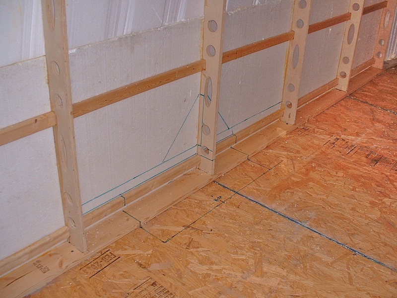

Thanks Guys !! Here’s some pics on how the frame is mounted to the floor .. We may be able to do some prying of the lower plate … but like PM says , a sawzall would be the ticket …
Tony , they ate little holes in the canvas ( through two layers of 18 oz. canvas , paint and all) right above the floor so they could nest inside ( escape the flooding , grrr !!!) , the water leaked in and spread all along the sides … Confirming the old RV observation , “ one leak can ruin a whole traier” … Had I done what I told everybody else what to do ( the Mix) I don’t think we’d be having this problem … :oops:
Steve, aside from not using the mix on the floor ( my bad ) the idea of OSB was a foolish one ( hindsight) … First Plywood , then OSB ...Two strikes … :duh: A sandwich floor sounds interesting , but I’m going to try a Board floor this time , like on my Old Cargo trailer … the boards are still fine .. some 25+ years old according to the previous owner...) Old timers used boards too …
But maybe a Board sandwich ??? :thinking: Whatever we use we’ll SURELY use the Mix on it … :thumbsup:

Postby ghcoe » Fri Jun 01, 2018 6:26 pm
Are your sills just screwed into the floor or are they glued too?
I had to separate my body from the floor and I used this tool https://www.harborfreight.com/oscillati ... 62279.html . I used this blade https://www.harborfreight.com/3-12-in-H ... 61817.html . Worked great!

The bottom plate /sill is screwed and glued to the floor , but given the softened state of the edges :o , I don’t think it would take much to separate it from the cabin .. Just that little bit of leakage took out pretty much most of the floor edges , the center area is still fine …
I just got one of those oscillating tools from HF , and a plunge blade, but I can get a Moon blade too…

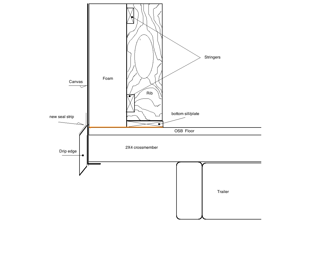

Postby GPW » Sat Jun 02, 2018 6:00 am
Here’s a cross section drawing of what we have … the orange indicates the glued area...

Postby GPW » Sat Jun 02, 2018 6:17 am
Looks like all we have to do is remove the drip edges , cut the canvas at the outside foam /floor join , and remove the rest with a spoon and saw … Just feeling around underneath , it’s pretty soggy :R Doesn’t look “that" difficult (?) :NC Famous last words … :lol:
Fortunately the cross members should support the cabin while the floor is taken away … we think ?
