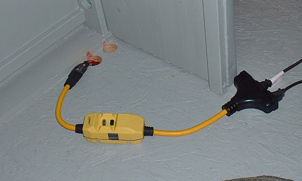

JMHO, I try not to build stuff in like that in , until long after you ve thought about it and tried simpler things first … my current ( excuse the Pun) electrical system is a short GFI adapter and a long extension cord … everything plugs into that … Easily replaced , or modified should needs change … You have to “Live with it” to clearly understand what you actually need and what is just excess baggage … I used to bring a lot of extra “stuff” that I never used … dead weight ...
