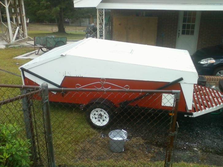

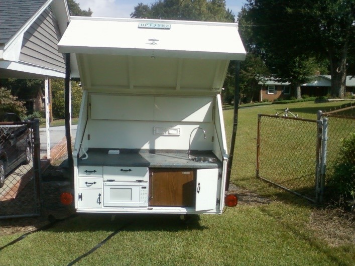

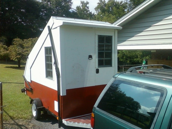

I don't know if you remember my first camper, I called it the pocket knife. It is a folding camper. The roof is hinged and the upper walls fold down. I'm re-making it out or foam this time and making it modular so that the entire thing can come off the trailer and be broken down and stored in my basement when it's not in use. So I'm making it in 11 sections. :? I know I'm crazy, but I'd like to still use my trailer as a trailer.
I'm very worried about warping, I'll need everything to fit together as it should. I'll canvas both sides of each piece like you said to keep the pressure even.
the reason I'm asking about washing is because blue jeans are made of canvas and we all know how much they shrink after they get wet and dry. :D
This camper will either be really cool or a complete fiasco. :worship:
