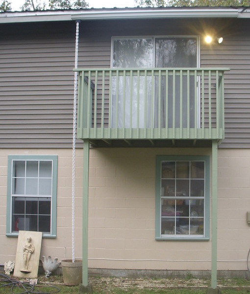

Postby GPW » Sun Nov 11, 2018 8:29 am
Guys, got my balcony project finished the paint went on fine over the “thinned primer coat “ … And we installed a short gutter and “rain chain“ to divert the roof runoff away from the balcony , which caused the paint to fail in the first place … We’ll be using the thinned paint for primer trick in the future … :thumbsup:
