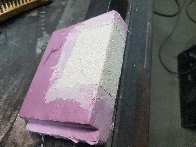

I was looking for an alternative to TB2 for the PMF exterior of my build since TB2 really isn't made to adhere to XPS and I don't really want to settle for good enough. The Durapro adhesive is made specifically to bond XPS to a porous surface and is a latex based material so latex exterior paint should bond well to canvas impregnated with it.

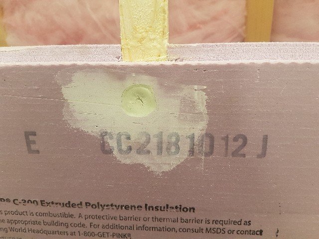

The adhesive is the consistency of drywall mud and smells like acrylic latex caulking. It goes on thick but still oozes through the canvas. When dry (24hrs) it is rock hard and bites into the foam. I have also begun testing it as a filler to smooth the outside of my TTT.
As you can see in the photo it does shrink when applied thick to a screw hole in the foam but I think a second coat will take care of that. I'm going to submerge the test piece of PMF in water for 12 hrs today and we will see the results of that tonight.

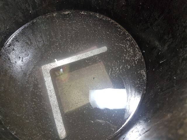

I've attached a pic of the PMF test piece which I lightly sanded and is now sitting at the bottom of a bucket of water. I'll let you know the results tonight.

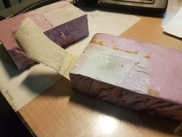

I don't see the lack of flexibility being a problem since as with a TB2 application the strength comes from the fact that it can not move. After I remove the test piece from the water I will slice it in half, one piece I will try to delaminate the canvas and the other i will try to break the foam under the canvas.

Well, after a good long soak in water I have learned some about this adhesive. The bond with the foam was unaffected by the soak and it refused to let go of the foam. The canvas however did manage to absorb water and this did affect its bond with the adhesive. After ripping off the foam the canvas was clearly saturated.
It should be noted that no top coats were applied to the PMF, just the adhesive underneath the canvas and what managed to seep through onto the outside. I think I will make up another test sample with a watered down mix to ensure full impregnation of the canvas and top coat it with the same diluted mix. I don't really want to coat it with latex paint because then I would really just be testing the paints effectiveness at stopping water ingress.
