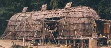

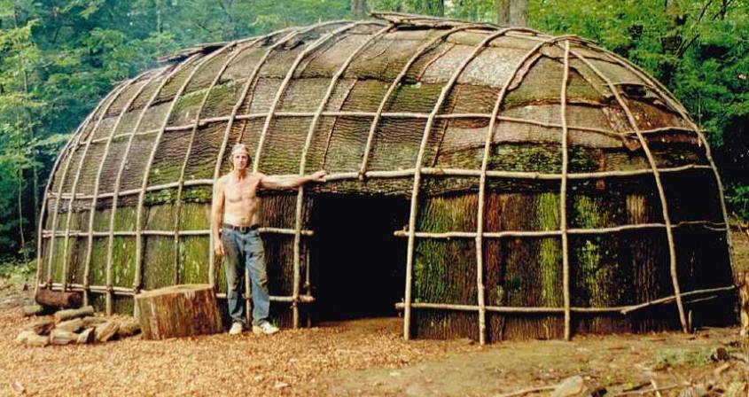

Postby John61CT » Wed Feb 13, 2019 5:39 pm
Thought experiment, please link to relevant previous discussions, or images / web pages to inspire brainstorming.
Flexible but strong structural framework, maybe temporary if no heavy roof / rack loading.
Curve / shoulder shapes and dimensions optimize balance between slipstreaming vs standing / storage space.
Maybe screening fabric for added strength, aluminum vs plastic?
And/or traditional dropcloth / canvas.
Not flat boards with 90° corners for foam though, the fabric gets stretched over the "sapling" framing, maybe bracing / twine tensioned to get everything nice and rigid, then spray or paint the Glidden Gripper (or what?) to "freeze" the shape
Coat, dry, further coats, maybe measure to get PMF shell to a given standard thickness.
Obviously a manufactured smooth rigid "mold" for commercial production, but I'm thinking hand made artisanal primitive roughness is part of the charm.
Once done, 100% dry and judged "strong enough" on its own
**spray** two-part urethane foam to the inside, again optimizing balancing lost space vs need for extra strength or insulation for a ski-bum scenario.
Even coverage a big challenge here.
Maybe an inside vs outer skin, gap in between then use two-part **poured** urethane foam. Denser at the bottom, lighter at the top?
Plastic pipe used for the sapling framing between skins, fill with dense foam, very rigid shape before skinning, no thermal bridging, likely load bearing enough for panels up top.
Semi-flex panels fit to the curve but mounted rigid, very light?
Entry / windows could be framed in, likely easier to get openings waterproofed, but maybe just do a unitary sealed shell for strength and shape-integrity, then cut out and frame later.

Yes that's the "organic" aesthetic.
My thought is to get that slipstream effect and frugal simplicity in a larger size, using more modern materials for durability and thick insulation.
Thinking maybe combine with that "Duckworks split shell pop-up" idea, bottom say 3-4 feet of the walls would need to be vertical.

You posted a pic of a ground-based structure in your original post. Is that what you're looking for, or are you looking for a mobile shelter?

Yes, seen those, and the Vardo designs.
I'm just spitballing using that basic form factor as the basis for a mobile living space.
Aerodynamic and very efficient, while still IMO suitable for implementing with cheap / low-tech construction methods.
Aesthetically might not appeal to current mainstream tastes, but I think calls back to Bucky Fuller, or rather, his designs called back to the indigenous designs.

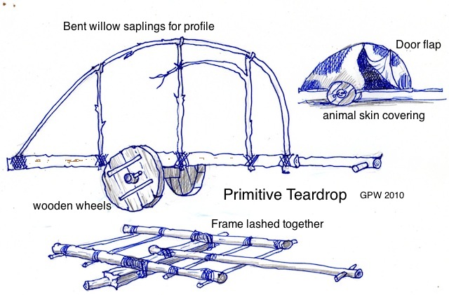

I really like the idea of a lashed frame.
Skin on frame kayak sort of thing. Much stronger than fastening by drilling a hole through the spar and it will flex.
But the sapling idea is too irregular to use realistically unless you can refine it. Whether you use a table saw to rip and then laminate curved members with epoxy (fast and strong) or go primitive and shave pieces down on a horse with a draw knife (painfully slow) or somewhere in between the skin will want to be relatively smooth which will require fair and refined spars. Further refinement might be to carve recesses to make the lashing lay flush. Scarfing long pieces are totally possible with lashing providing there are cross dowels of some hard material to keep the pieces from sliding.

Adhesives are crazy strong and reliable nowadays, many acting as sealant, remaining flexible forever too, I don't see lashing / scarfing etc needed myself.
Any flexible or bendable tubing will act as main load-bearing support "saplings". Bigger / stronger in fewer numbers spaced out, or lots of weaker ones like a basket-weaving concept would both work, I think the latter likely to both be stronger and give a more unified aesthetic.
