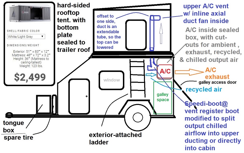

Postby working on it » Wed Feb 20, 2019 9:43 am
John61CT wrote:Putting electricity and a separate small AC unit where it's needed will be more effective, more reliable and ultimately cheaper than a Rube Goldberg / MacGyver DIY project.
I'm a big fan of Rube Goldberg / MacGyver DIY projects, so I considered this set-up I considered, based on my basic trailer (as if I'd ever need extra sleeping room on top?).
as-if set-up for foursome camping
Rooftop tent to utilize single airconditioner, shared with trailer.jpg (149.82 KiB) Viewed 1348 times
But, if I had needed room for four, I'd have to put two people up top, preferably in collapsible RTT, like this Maggiolina. Pehaps something like this might work better for your situation than having to deal with plenums and ducting all over the place, strung several feet between trailer and vehicle?

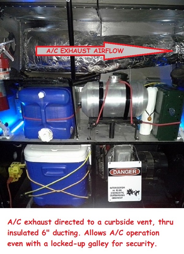

Of course, I'd need to "redneck engineer" new ducting up to the RTT (and probably upsize the unit from 5k BTU's to 8k. And reroute my A/C's sideways exhaust routing straight out a louvered vent in the back, after re-configuring my galley/storage area, into a sealed back design, with access door, instead of the huge hatch it has now. And move my fishing-rod storage tube from top to sidewall. But, it would be possible....
current set-up for solo camping
Air conditioner exhaust ducting.jpg (177.97 KiB) Viewed 1348 times
I like the idea, but $2500 is what I paid for my last car (I'm pretty cheap). Though when I lived in Denver some of the fancier gear junkies I knew had vehicle top tents and seemed to like them a lot.
