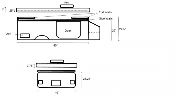

I am looking for advice and assistance with a foam trailer build. Newly registered member but definitely not new to the site. I’ve been browsing and admiring the builds, innovations and insights from everyone here.
I built a small teardrop several years ago and want to improve on what I did. The new build is in the planning stage. It will use foam and the poor man’s fiberglass. I also want to make it a fold-up trailer similar to the Gobur, Esterel, Rapido and Apache that I have seen here and in videos. I have reviewed the vintage Folding Trailer (2mb) plans but I still have some concerns about the build. Done quite a bit of research and have also roamed my limited mind to no avail which brings me to this forum in search of help.
The plan is to build a foamie with 4 folding walls like those mentioned above. The idea is to make this aerodynamic, lightweight and simplistic. It is to be pulled by my motorcycle and will be set-up as a solo occupant build. The trailer dimensions will be 40”W x 80”L x 40”H (+roof) using 1” XPS. The lower walls are to be 22”H and the upper walls 18”H so that the only overlap will be the upper end walls over the upper side walls which will be parallel when closed. The roof will be about 4”H to allow for a deep lip. I understand the lower end walls will need to be offset (taller) than the side walls to allow for closing/folding over the side walls.
My questions are: How do I design the roof and walls to fit when folded in traveling mode and when set-up for sleeping/camping mode? How much offset do I need to plan for in the lower and upper walls builds (wall depth + hinge offset)? Special accommodations for the roof build to allow for proper closed and raised positions to provide a weatherproof seal? Do I need a flap/overlap for the corners and upper walls over lower walls for weatherproofing? Honestly, what I am seeking is a design, drawing or plan that I can preview. I am a visual person and seeing a layout with notes would be very appreciative.
Here is an outline of what I am trying to accomplish.

Maybe make some small ( 1” = 1’ ) models out of scrap cardboard boxes and duct tape …. “see how they Fold “ ??? :thinking:
Re: Folding Foamie Advice Requested
Postby FootLoose » Thu Mar 14, 2019 8:31 am
Thanks everyone,
Appreciate the videos and encouragement. I think I will use some actual material to do a small mock-up as well as using cardboard so I can see the build in 3D and address any concerns with the design and clearances. I look forward to seeing what you come up with on your own projects. I have seen what GPW is capable of ... nice, very nice.
Postby Tomterrific » Thu Mar 14, 2019 9:14 am
I'm not sure how helpful this is but...
The first side folds in to the floor. The opposite side folds over the the first. To lay flat on top the hinge must be raised up to the thickness of the first side. I wish I were more eloquent. :-(
The top, or roof, of your structure can have an over hanging edge, like a hat box lid, around which the walls fit inside.

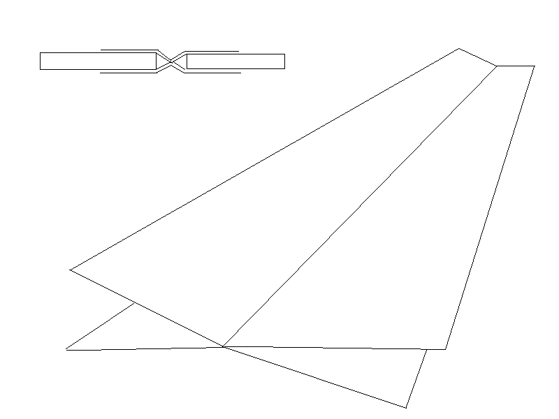

Postby GPW » Sat Mar 16, 2019 6:20 am
just a thought … we have the possibility of completely waterproofing a piece of canvas through and through , but not with something like T2 that dries hard , but more with something Acrylic “medium” like I use on painting canvas , which we roll up all the time ( flexible)
I’m just thinking two pieces of fabric sewn together down the middle like the old control surface hinges we used on model planes ...
Postby FootLoose » Mon Mar 18, 2019 6:17 pm
Appreciate the responses & hijacking. :thumbsup: It's all about learning for me.
I went back to the cardboard box as suggested and it hit me, :? , i was trying too hard to understand how the upper walls would work when all I had to do was reverse my own process. Just fold the upper short-length end walls in first then fold the upper long-length side walls which will be side by side just like a cardboard box does, DUH!
I like your idea GPW of the canvas hinges and plan to incorporate it into my build with the sewn hinge offset to the interior side of the wall. It will go nicely with my desire for lightweight and simplicity. The water-sealing does concern me a bit but you gave me some good advice on how to treat it. I have also followed GHCoe's 1st foam build. Have gleaned several good ideas from it, especially with the edging and the hotwire use.
