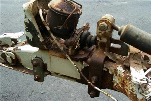

Anybody ever seen a hitch coupler like this? Surge brake? Stabilizer? Trailer has electric brakes...

Is that a shock absorber on the coupler??? What’s it supposed to do??

MatBirch wrote:...Anybody ever seen a hitch coupler like this? Surge brake? Stabilizer? Trailer has electric brakes...
surge brake shock absorber.JPG (133.76 KiB) Viewed 2366 times
* Looks like the trailer had surge brakes (hydraulic), but was changed to electric brakes later on. I don't see where the old master cylinder was mounted (maybe underneath the tongue?). Perhaps the brake system rusted-out, and it was easier to convert to electric.

My first thought was surge brake as well, but in thinking about it, it’s the wrong orientation? Also, there would have to be moving connection between the ball/coupler and the tongue. It is all solid, and shows no sign of being modified. There is also nothing under the frame. There is an old propane line, but nothing that could have headed to wheel cylinders or anything.
My guess is some sort of anti-sway or equalizing attachment :thinking:
Actually, just found this- appears to be the same, or at least was at one time... 1972 Jayco pop up
I have a late 60s Steury popup frame I am intending to build on. It has surge brakes and a separate similar shock absorber looking thingy. I don't recall if it is part of the surge mechanism or not. It's in a storage unit, I'll be up there in a few days and I can get a better look at it and maybe a picture.

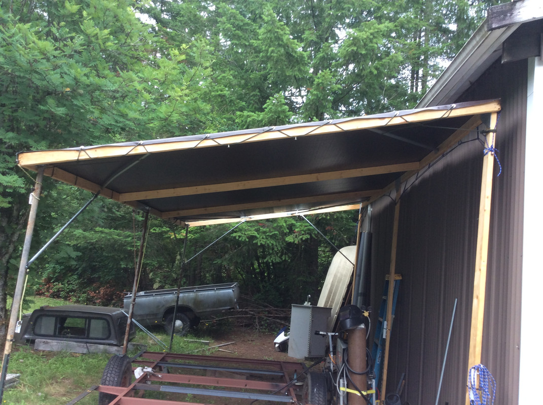

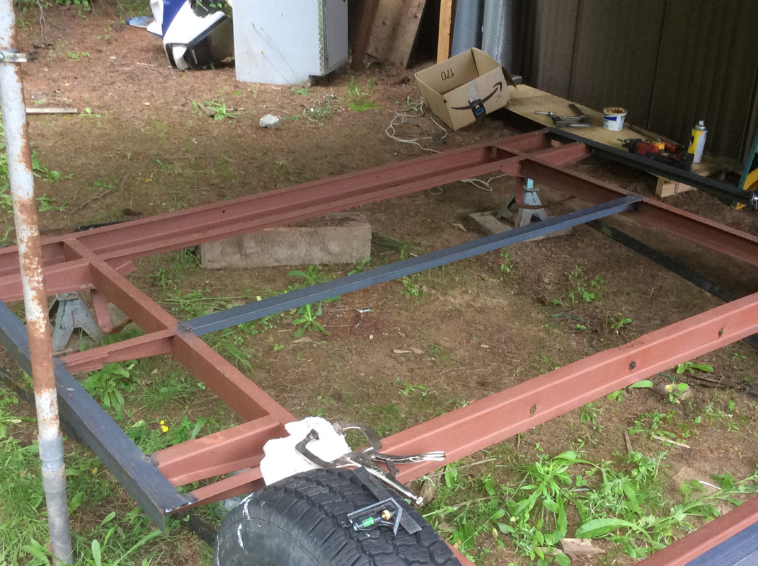

Got a little update finally! It’s been a busy spring and start to the summer, and money is short. I finally got two nickels to rub together and got a little bit done on the trailer.
First however, I needed a place out of the weather so I built a quick and dirty shelter. It’s been working out very well. The garage tent things never last anyway, and this gives me more height to work.
I picked up a length of steel angle to add to my scraps, and was able to get all the repairs and additions to the frame done.
Tomorrow I should be able to get the tongue replaced and welded up. Then I’ll fab up some fender wells, so I can see about that floor! 8)
