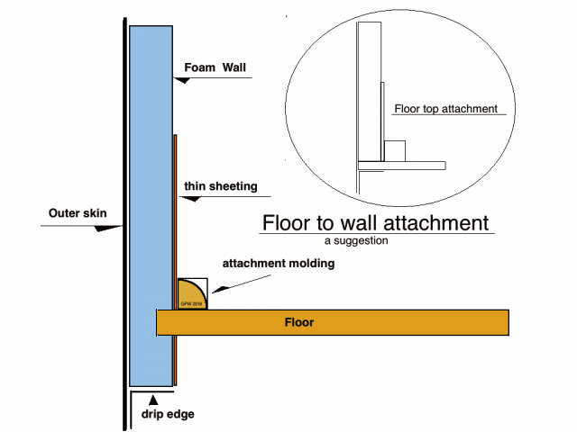

We’ve ever just used Butt joins to glue the Foam , and maybe the thing to consider is the skin (s) and any other structure as a whole unit ( unibody) … using every part to strengthen the join to other parts … We’ve even thought about using wood and thin plywood as part of the structure for critical areas such as floor to wall join (see drawing)
But then the butt-joined simple Foamie we made at first lasted just fine …and got towed across country when Bonnie got it … and then she had to fight to cut the floor wall joins for her modifications … that was just foam /thin Linen canvas and used bedsheets inside … :thumbsup:
Sometimes we tend to overthink the possibilities , which can only lead to overbuilding , which is really never a bad thing eh ... ;)
156655
Ps. I can even see in the drawing ^ that a notch ( Dado ? ) in the foam wall - floor attachment would make assembly easier and still use the extra gluing area of the sheeting … a simple hot wire tool makes notching pretty easy and accurate ( stinky , but less messy than a saw notch ... :thinking: )
