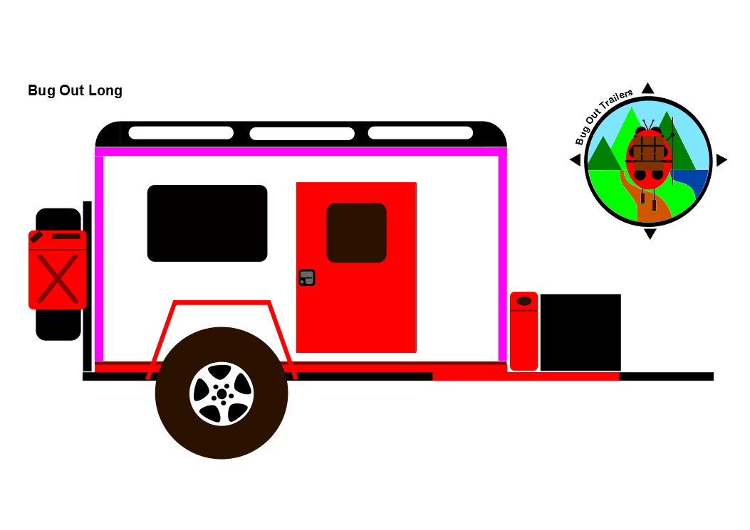

I am currently (as I type instead) installing a 2"x2" tube with receivers tubes welded on both sides. It will replace the current hitch system and allow me to switch out from a standard ball type hitch to a pintle hitch. It will also allow me to slide in a accessory in the back, like a bike carrier or cargo carrier. This modification strengthens the known weak Harbor Freight A frame hitch system which is generally good for on road use, but not up to the task for off road service. This will alleviate the up and down forces on the stock A frame and spread the towing forces across the entire trailer as well. Also, it will add a rear receiver hitch for a bicycle or cargo carrier in the back.
Future plans are even bigger tires (to match the tow vehicles), longer springs (even softer riding), Larger axle (to avoid bending in tough terrain), roof rack, front carrier, inside shelves, pull out kitchen/cook area. Can I do it? I don't know, but I feel confident that I can. So stay tuned.
Bug Out Long
Bug Out Long small.png (50.32 KiB) Viewed 6570 times

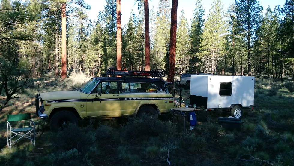

I did encounter some fairly rough roads on the last trip from time to time. Real bad washboard and some rocky stretches. Definitely places you would not typically find trailers. Performed very well even with the smaller tires.
The worst problem I am having right now is the trailer is getting sandblasted on gravel roads. Mud flaps would help, but I do think I will need more than that.
A awning would be helpful since it did rain a bit last trip. So going to have to look at some sort of mounts.
Overall I am quite satisfied with it's performance on and off road as of right now.
I was able to set up and break down camp in under 10 minuets. Even when I had a friend with me that had is gear in the trailer too. I had to reconfigure for carrying his stuff during travel and back once in camp.
