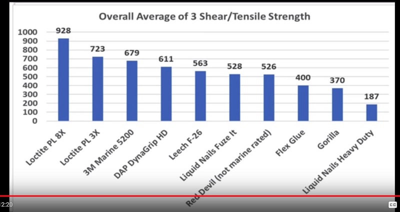

* I still think that Loctite PL Premium 3X adhesive is about the best TTT-building adhesive out there. A recent YouTube video backs up my choice.
* Though I don't know about any of the construction adhesive/sealants' abilities to work with "foam", but the YouTube videographer "Project Farm" uploaded results from his "Best Construction Adhesives" tests (part 1 @ https://www.youtube.com/watch?v=JyudWdOgrNc, part 2 @ https://youtu.be/hukFoQ4GIk8 that he conducted on wood and pvc, in two installments. Here's a screen snip showing his results:
best construction adhesive test summary, Project Farm video youtube.JPG (78.76 KiB) Viewed 3047 times
* I had always thought that the Loctite PL Premium (3X) adhesive that I chose to use on my trailer build (starting in the fall of 2011) was a good choice, better than the Liquid Nails HD that I'd previously used for some time, and his tests confirmed that. I don't think that the winner of his tests, Loctite PL Premium (8X) adhesive was on the shelves at that time (and I probably wouldn't have paid the higher price for it...mine was a low/no budget build to start with), so I got the 3X and have been happy with it over the years.
* "Project Farm" notes that tough the Loctite 3X and 8X aren't rated for "full" waterproof capabilities, and 3M 5200 and others may be more waterproof than them, for my usage (90+ % stored in a dry garage, exposure to T-storms maybe 10 times a year at most) the Loctite PL 3X has been truly great holding the wood together, without any signs of leakage or separation. I used at least 10-12 tubes of it during the build (on every single seam, inside and out, redundantly), more for mods and alterations, and the only other adhesives/sealants used were TB2 (between floor layers), Gorilla Contact Cement (in small, highly visible screw placement situations), and OSI Quad (around window frames, where its' non-drying, flexible properties were needed). I guess if I were to build it over again, I probably would still use the 3X (but if in constant rainy situations, perhaps the 5200 would be better, maybe not). But, for the price, it is the best.
