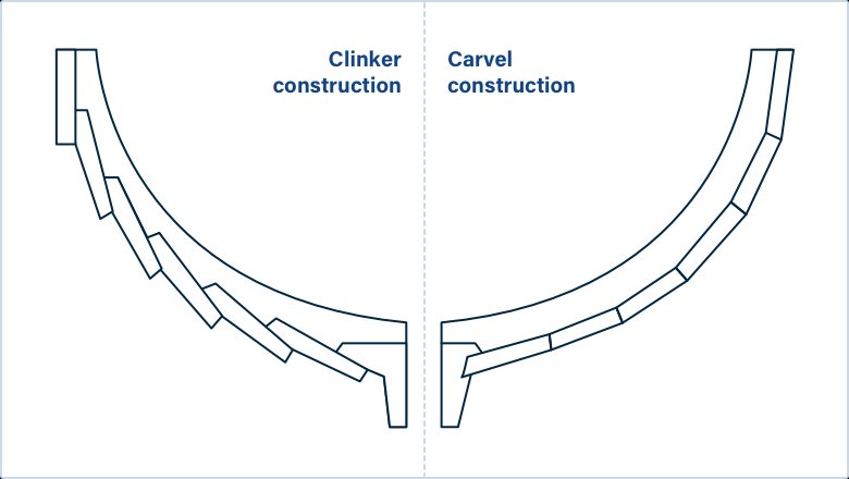

So, for more clarification, I am actually working in boat building. What I'd like to do is use long lengths of foam for lapstrake/clinker planking on a catamaran/proa. I would need to be able to be sure of a complete seal between overlapping sections. (see left half of image)

What length do you need? You'd have to remove the plastic film on both sides which is a pain. You might be able to get some scrap from a siding contractor to experiment with. I assume you plan to fiberglass the hull once planked?
