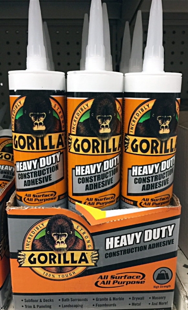

I used the Gorilla "Construction Adhesive" sold in a caulk tube. Was surprised it looked like caulk, applied like caulk, dried white like caulk and was very easy to work with, appears to hold very well. Do think this suitable for gluing the 2 inch foam to the trailer? Want to build a very basic sleeper like ghcoe's "#2".

Postby JazzVinyl » Thu Sep 05, 2019 3:41 pm
RJ Howell wrote:Following on the tube adhesive. I am used to the GG and water, so I went that way. Curious how the tube GG works..
Yes, this stuff:
It is plenty strong enough to keep the cooler together, what should I do to test to see if it is strong enough to keep the 2 inch foamie rectangle attached to the trailer floor at highway speeds?
Cheers!

Postby ghcoe » Thu Sep 05, 2019 9:45 pm
Yes, this stuff:
Cheers!
That is my glue of choice in my builds now. Expensive, but seems to work better than anything else I have used. I did some tests with a few products a couple years ago and posted here http://tnttt.com/viewtopic.php?f=55&t=6 ... =glue+test . I will bump it to the top too.
The real strength of the foamie wall to floor bond is not necessarily the glue you use on the floor to wall bond. Yes it will hold things together to a point, again the weak link is the foam. The real strength is the canvas that wraps around everything and is glued to the bottom. Effectively creating a sock.
In my builds I install what I call inner frame rails. Basically a base board that runs on the inside of the wall and is attached to the floor. The wall is then sandwiched between this inner frame rail and the outer canvas covering. This effectively creates a channel that makes the glue lines on the wall side and frame rail side work in shear. Shear is where the strength is at on a foamie build. This also makes the floor ridged right at the floor joint so the there is no floor flexing which could work on a glue joint. I do know this can happen because on #2 I decided to leave out the inner frame rails and had some issues. I then installed the rails and no problems since.
