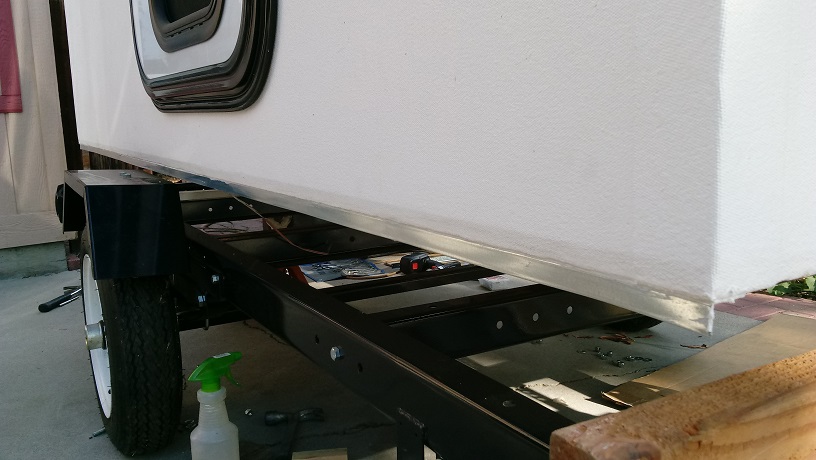

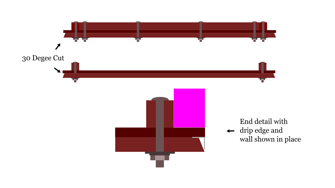

The drip edge idea is a good preventative idea, I'd like to see a picture of where you put that on the camper.

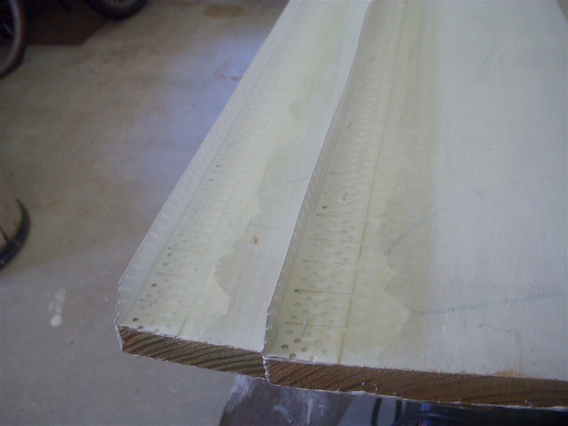

"The drip edge idea is a good preventative idea, I'd like to see a picture of where you put that on the camper. “
We used George’s idea and fastened some corner moulding to the outside edges of our floor boards ( see pic ), then covered over them… Easy, works great !!! ( solved all my water problems )
The pic is shown with the boards upside down ( naturally ) and secured with Stainless steel staples and the Gripper .

Yes, you don't want the canvas right on the trailer frame. With the TBII and paint it acts like sandpaper on the paint on the trailer. I would imagine with time the trailer would wear through the canvas and cause more issues. I added 1"x2"'s to lift the body up off the trailer and to add room for the drip edge.
Spacers
Floor Spacers s.png (35.89 KiB) Viewed 3907 times
Drip edge
