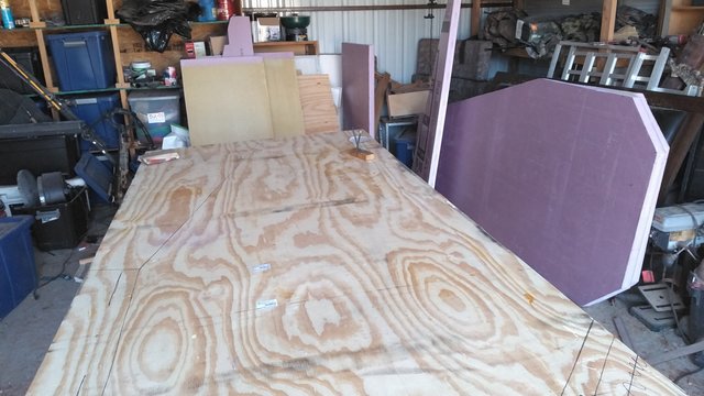

Postby Tx River Rat » Wed Dec 11, 2019 8:13 pm
Yesterday I picked up 4 sheets of 2 inch foam some tb11 1 piece of 5/8 ply. This morning cut out my sides got one side covered for the inside.. More tomorrow

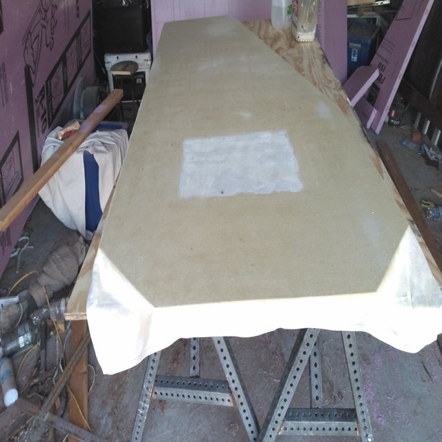

Postby Tx River Rat » Thu Dec 12, 2019 10:21 pm
Here one pic I think

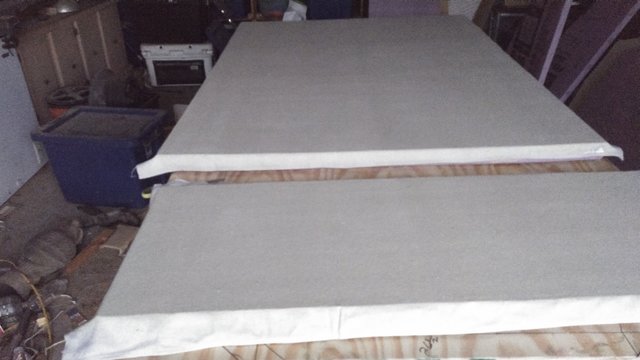

Postby Tx River Rat » Fri Dec 13, 2019 7:55 pm
Got all the parts cut out and shaped today and about 2/3 of them covered with canvas on one side.

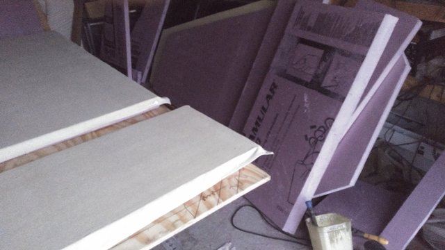

Postby Tx River Rat » Sun Dec 15, 2019 4:41 pm
All panels covered and trimmed

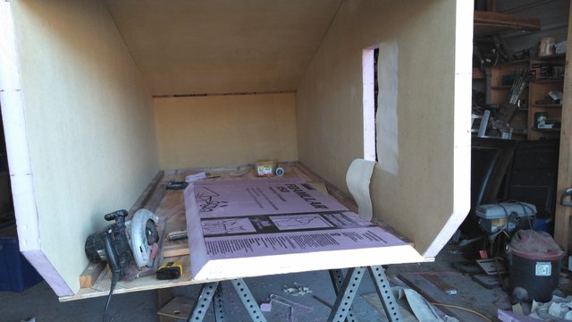

Postby Tx River Rat » Sun Dec 15, 2019 4:44 pm
tacked partially up

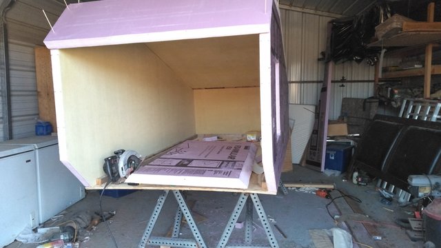

Postby Tx River Rat » Sun Dec 15, 2019 4:48 pm

Postby ghcoe » Sun Dec 15, 2019 8:34 pm
Looking good. Nice miter cuts on your end pieces. what trailer are you planning to use?

Re: Motorcycle teardrop out of foam
Postby Tx River Rat » Sun Dec 15, 2019 9:52 pm
I will fab my own trailer . Was in the steel fab business so have built a lot of them
