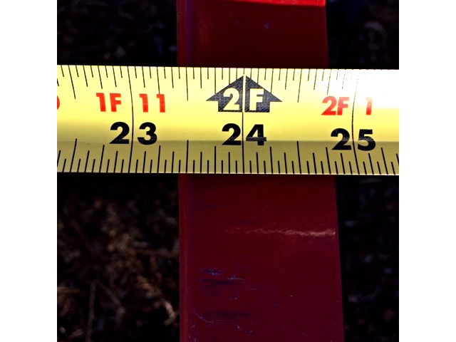

My first cross member is at 24 inches (as expected):

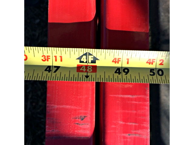

The Second cross member will need 47 and 1/2 inches:

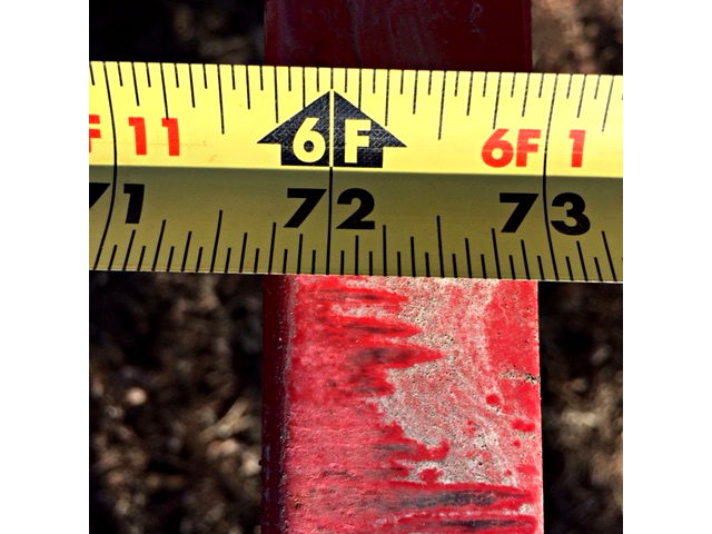

The Third cross member will need 72 and 3/8 inches:

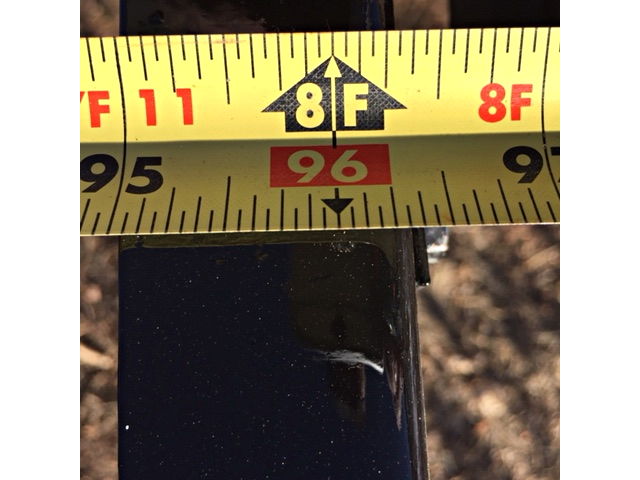

And this shows the overall length of this trailer to be 96 and 5/16 inches:
So the question is...can I expect a new trailer to match these dimensions exactly? Or should I wait until I buy and build the new trailer to build the floor?
