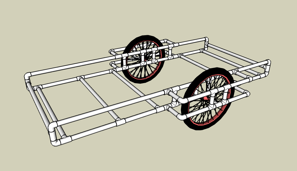

Postby gill2161 » Mon Jan 27, 2020 7:26 am
well i have been doing a lot of research and i think i might found a light weight solution for the trailer and design. trailer made from PVC still need to find data on how strong this might be and total weight. like to hear all of your input and expertise about this plan.

Postby RJ Howell » Mon Jan 27, 2020 7:47 am
I'll let an ME state the structural values of PVC. What I will say is I build many things around the yard with PVC (small greenhouse, archery stands, solar panel stand, wood coverings, etc...). None which tend to stand up more than 3-4yrs no matter how I coat them. Nature just gets the best of them. The side of running down the road with it.. Let me tell you about my commercial trailer and the 2" x 4" x .01 tube steel frame no only bent, but fractured from hitting a shallow pothole doing 50 mph on a freeway. The stress placed on the frame is far more than you'd think. My opinion is the PVC would not hold up.

Postby GPW » Mon Jan 27, 2020 1:14 pm
PVC trailer ??? Now that’s a valid question , and if you ask around here most likely the answer will be NO !!! ( but don’t let us stop you from experimenting !!! ) There are traditionally No Rules around the Foamie Forum , just lots of "Suggestions” … ;)
Ps. They long told me a foam trailer wouldn’t work at all … :R
And if you must , I believe the Gray PVC is STRONGER … Good Luck !!! Send pictures !!! :pictures:

Postby pchast » Wed Jan 29, 2020 10:11 pm
I question the durability where its almost constantly flexing(like in the draw bar). A larger diameter or an internal structure to resist flex may make a difference. {I'm NOT a structural engineer}

Postby Aguyfromohio » Thu Jan 30, 2020 12:01 pm
Using PVC (or any other common cheap plastic) for a heavily loaded part will teach you the engineering concept of "creep".
"Heavily loaded " is pretty subjective, but for example if a 125 pound load will break the part suddenly by snapping it in two, I would say it's getting heavily loaded when it's carrying 20 pounds or so. If it's' only carrying two pounds, it's "lightly loaded".
When plastic is heavily loaded, it "creeps". Over time periods of days and weeks it will slowly deform, stretching and bending very significantly and essentially failing in slow motion.
Metals don't creep. Wood does not creep. Cheap plastic does creep badly. It's a material property caused by the molecular and crystalline structure of the basic material and you can't change it.
Special expensive plastics are available that don't creep, they are usually called "engineered plastics". The plastic parts on your car are engineered plastic materials that don't creep.
PVC pipe will creep, so I would never use it for a trailer frame.
Use thin wall lightweight metal tubing or wood instead - it will probably end up being lighter than PVC pipe anyway. PVC pipe is pretty heavy, compared to metal tubing or wooden sticks of equal strength.
