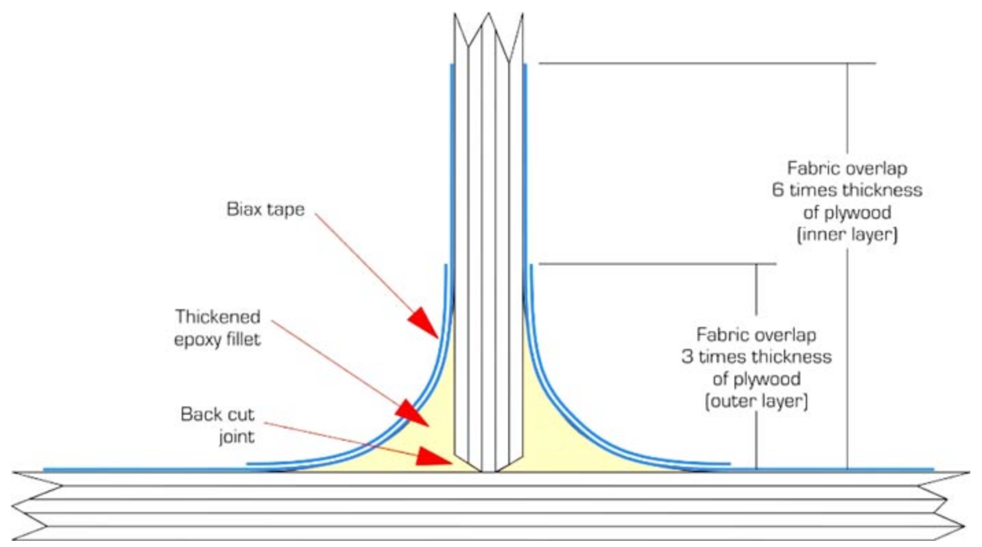

Hello,
If I was working with fiberglass, epoxy, and plywood, I would likely use thickened epoxy to fillet the inside edges before laying up the fiberglass. (sorry the image is so wide).
Screenshot_2020-04-08 Duckworks - Liquid Joinery.png (359.07 KiB) Viewed 1172 times
