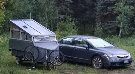

At the time, I had a Honda Civic and wanted a very lightweight option. I ended up building a small wood trailer (years ago), which served it's purpose as a camper and utility trailer. I now have a Subaru Outback (for the past three years), and decided it is time to build a nice Foamie camper home. I quit the corporate job a few years ago, hundred hour weeks, living in a metro area, never used vacation and I noticed the past 2 1/2 decades of life slipped by in a blurry memory of nothingness. So long story short, I ditched my townhouse and a ton of stuff I accumulated, hit the road and turned and started living my dream of traveling and fly fishing.
Old Trailer w/ my old car

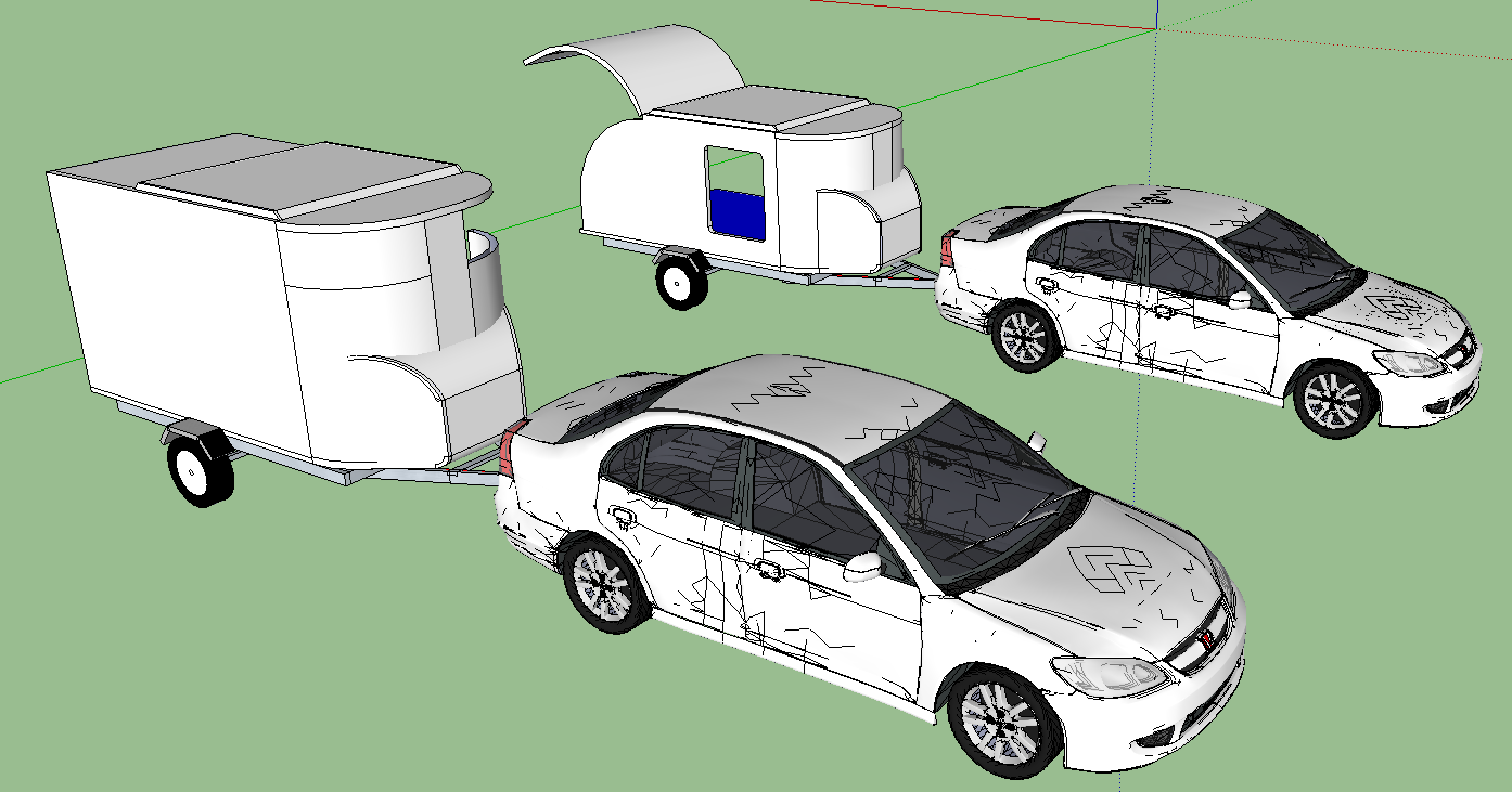

Originally I had sketched this up and was intending to build it on the ultra-light 5x8 Northern Tool aluminum trailer, but since most of my time is on the wind and ice blasted roads in Wyoming, and I know what it is like to tow a trailer diagonally down the road in a winter storm with a Honda Civic, I decided I needed the extra weighted base, particularly since I will be building this trailer with about a foot more height then the standard teardrop. I recently found a good deal on a used 5x8 Carry-On Trailer. The angle iron design does have negatives, particularly some of the frame flex, but I will be adding a little support (want to keep the weight down however), so mainly am planning on support from the floor and uni-body design of the foamie shell.
I originally was also intending to build a teardrop with the Camp-In 560 Raindrop style, and the u-shaped front end. Since this trailer will mostly be my home, I wanted the extra room and headroom, so I opted for a cargo type trailer, but keeping the u-shaped front. I know the u-shaped front won't help much with aerodynamics, but I like the look of it. I likely will ad top and rear foils to mitigate the wind drag on the square back end however.
Original Sketchup Designs

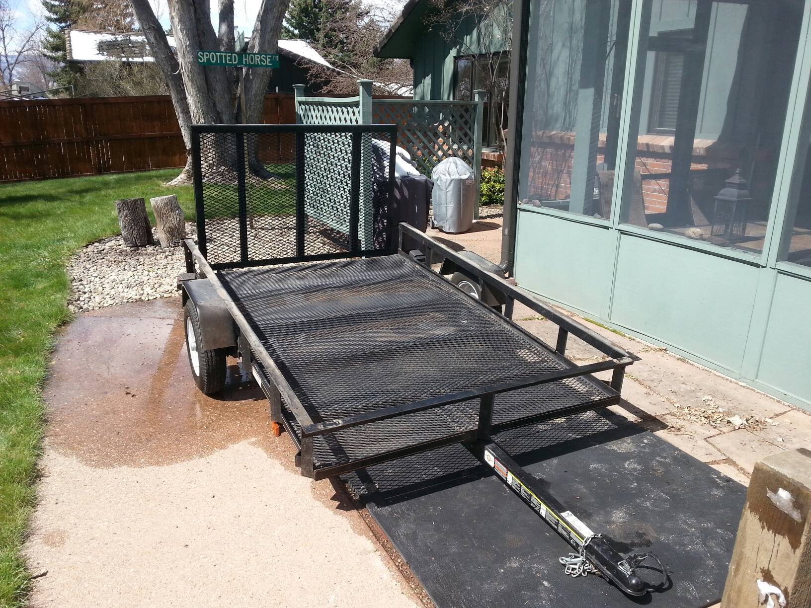

I'm late to posting, so I'll catch up with some following posts, but here is a pic of the 5x8 trailer I bought a couple weeks ago ->
Carry On 5x8

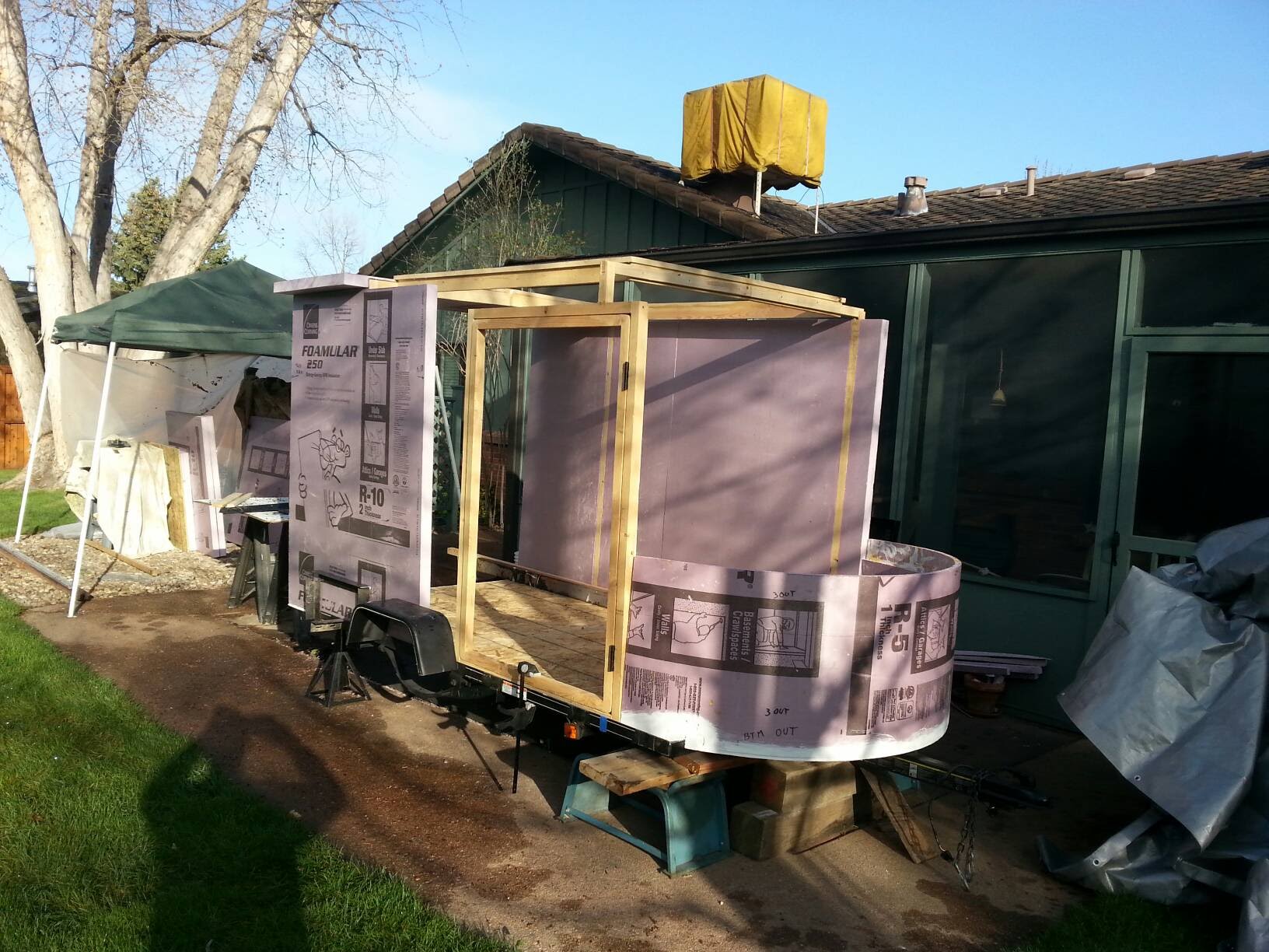

Since I'm behind in posting, I have a few pics to catch up on the progress.

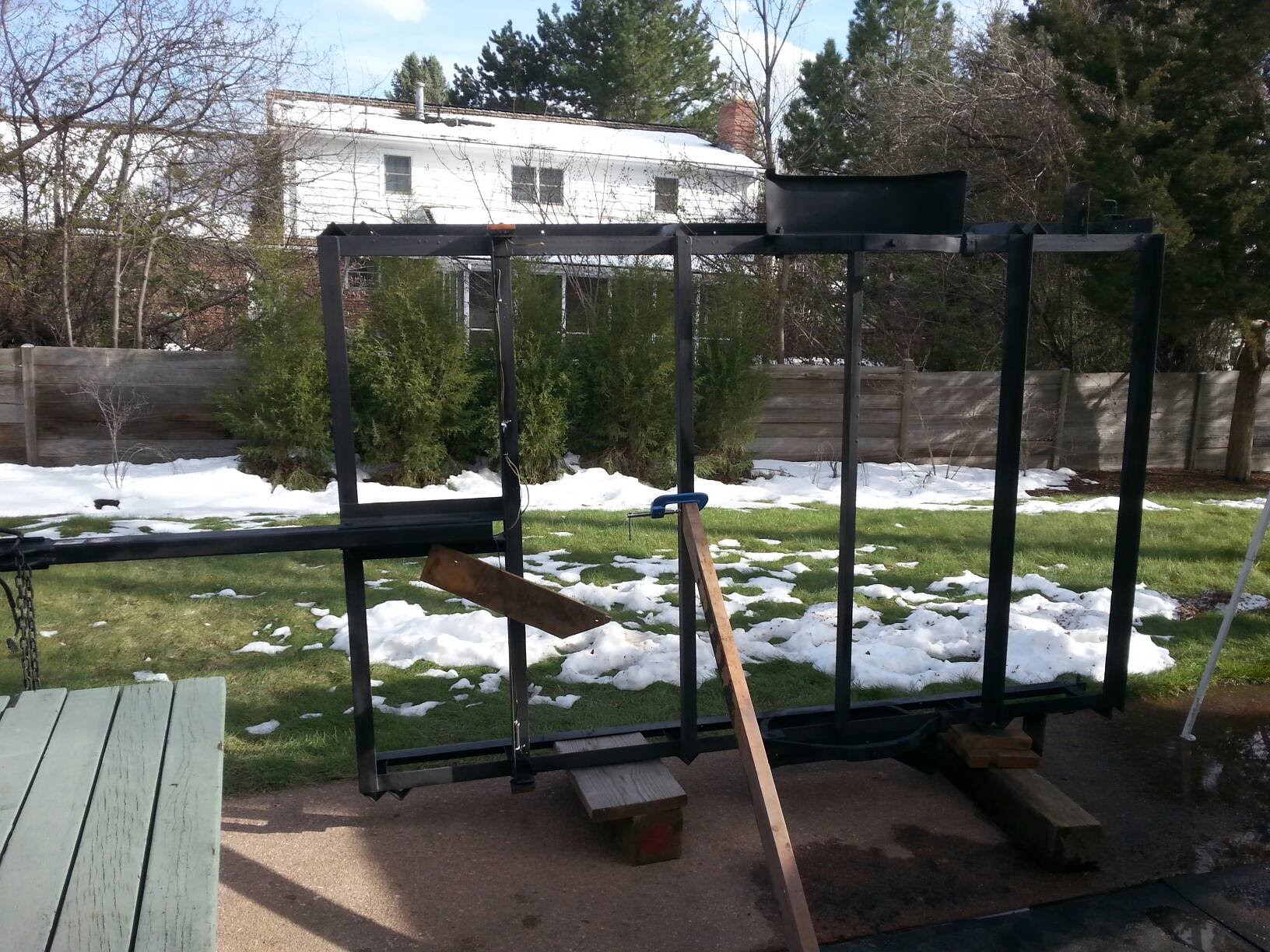

I removed the tailgate ramp, ground off the hinges, removed the steel mesh floor, and started on the rust prevention work underneath the frame.
Rust prevention work underneath the trailer frame

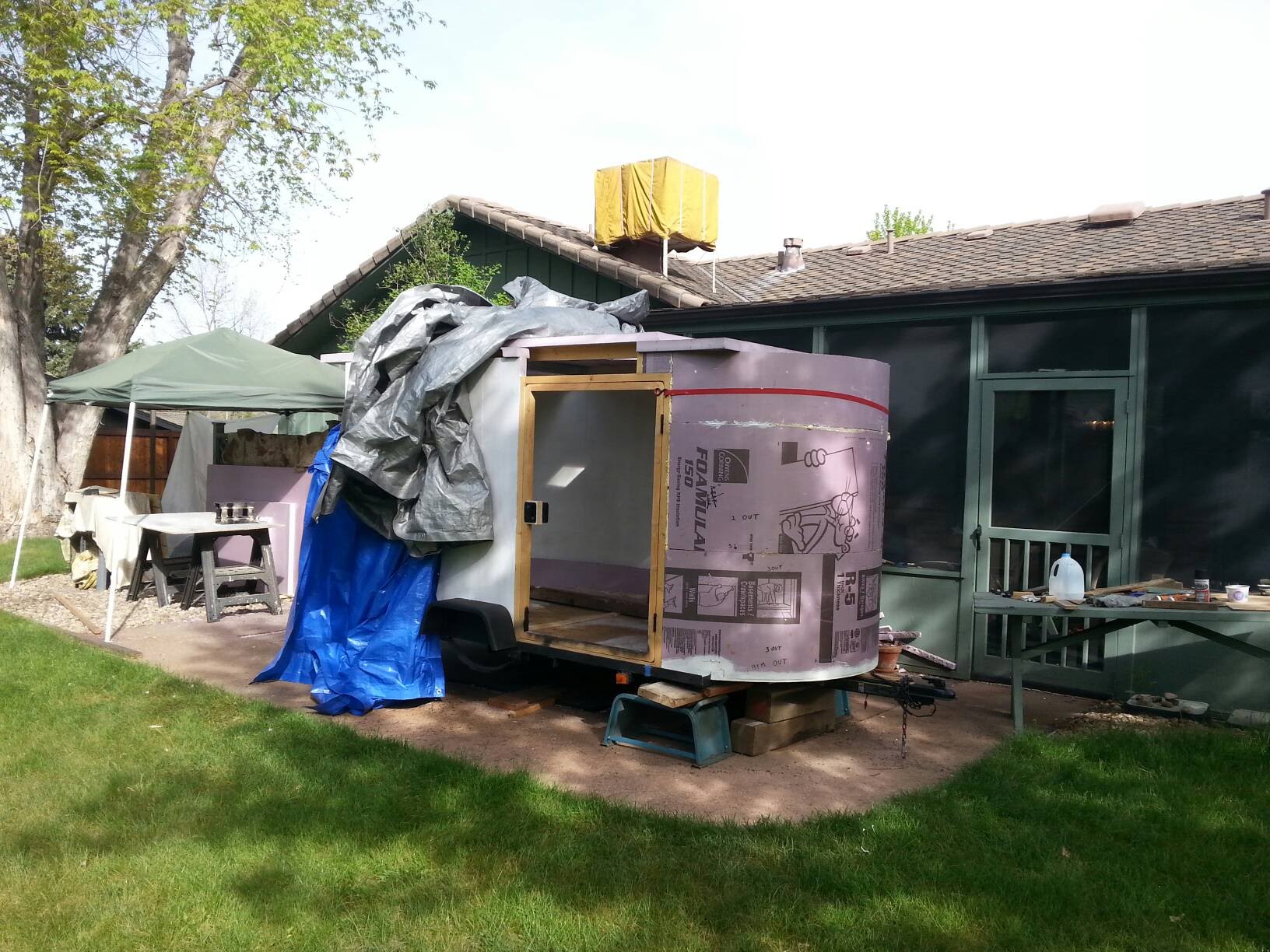

I have since cut the OSB boards, painted the underside w/ Henry 587 Dura-Brite White, Elastic Roof Coating. Kerfed a couple some 1" foam panels for the 30" radius front, and started to fit some of the panels. I have also started the build of one of the doors. I'm going to be putting in a simple pop-up roof, and have started the frame structure. Also have ground off the front rail and part of the side rails of the trailer.
Fitting the foam boards and popup frame

With the trailer you have with the single bar tongue, make sure you anchor your floor real good on the first cross bar that's not the outside the tongue is welded to. The other angle stuff is ok but this is the weak bending point unless you use the strength of your camper to keep that from happening. Other than that point you should have no problems. Is that 12 or 13 wheels?

linuxmanxxx wrote:With the trailer you have with the single bar tongue, make sure you anchor your floor real good on the first cross bar that's not the outside the tongue is welded to. The other angle stuff is ok but this is the weak bending point unless you use the strength of your camper to keep that from happening. Other than that point you should have no problems. Is that 12 or 13 wheels?
Thanks linux, will do on ensuring the floor is bolted strongly to all the cross members, particularly behind the tongue. I also have extended the tongue inwards to the next cross member just to be safe. Unfortunately the wheels are 12s, but I intend to upgrade later this summer when more funds are available (and before I take an extended fall road trip).

Had not spent a lot of time lately with this project, but back on it.

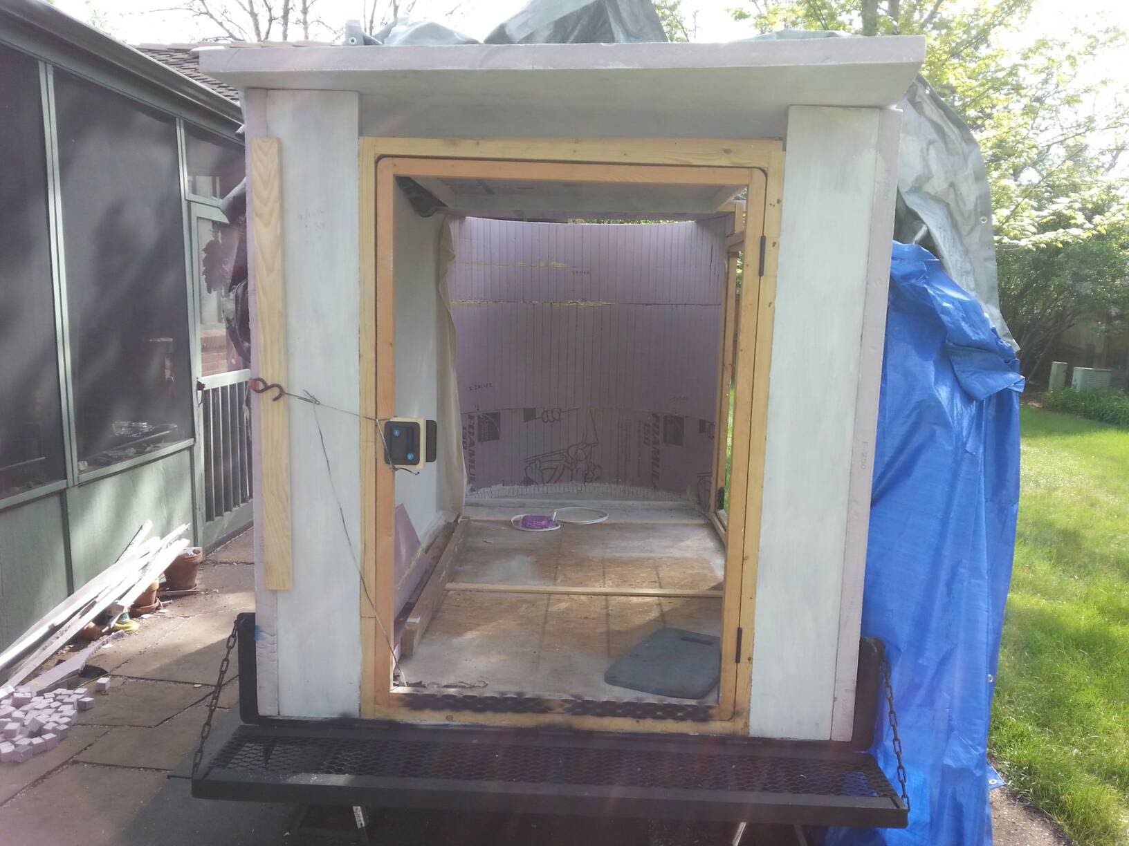

I did extend the back of the trailer frame by 12" and added a hinged tailgate to the back. Primarily to prevent a high bumper from pushing the back of the camper in with a low-speed traffic light bump, but certainly won't protect very much over 1/2 mph or so. I also wanted the tail gate however, for changing fishing waders, leaving muddy shoes on the grate overnight, place to put tools, place to put a stove etc.
Short vid showing the progress and demoing the tailgate.
Added rear tail gate that swings up and latches.
Have been adding some of the sides and the front panels.
