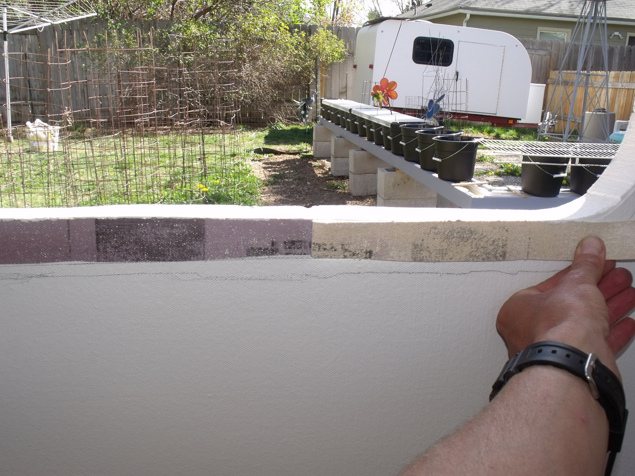

These is the results on my last build. I had to make the window opening a bit bigger on #3. I cut the canvas to remove it before trimming back the foam.
In this case I am pulling the canvas off of the exterior of the trailer. On the exterior before applying canvas I spackle and then apply a coat of primer. This is probably about a week after applying the canvas. You can tell that the primer/canvas is indeed pulling a pretty good amount of pink off the foam.
With Primer

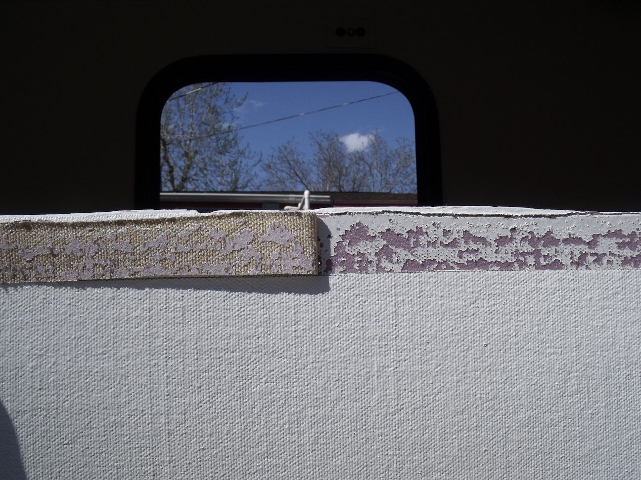

This is the interior. To save costs I usually do not prime the interior walls before canvasing. Even without canvasing you can see the print pattern on the foam mirrored on the canvas. This indicates to me that indeed there is a good bonding there. If you look closely you can see a good amount of pink too. I don't remember exactly when I applied the interior canvas, probably over a year ago though.
Without Primer
As you can tell in both pictures there is a bond using both techniques. The issue is how strong a bond. The thing to keep in mind is that foam is not very strong and it does not really matter how strong a glue agent you use it will fail at the glue line. With that said I do feel I have a bit better bond to the canvas using primer first and the TBII to apply the canvas. As you can tell in the pictures TBII bonds real well to the primer and the primer seems to do a bit better bond to the canvas.
I also feel that when applying your primer over the applied canvas it is good to use a roller and work the primer into the canvas. The roller will squish the primer into the weave of the canvas and help some with the bonding of the canvas to the wall as well. Wood canvas canoe makers actually use a brush with real short bristles to work their dope through the weave to the wood underlayment.
