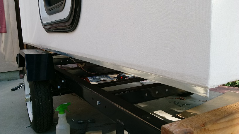

I install mine after the canvasing is done. This is drywall flashing. I usually attach with 1/2" truss screws. Just start the screws then apply caulk between the flashing and floor then finish tightening the screws down. Wipe off excess caulk.
Drip edge
