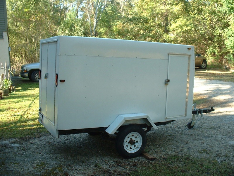

Just an idea … 1/4” Fan fold foam ( floor underlayment) should supply adequate insulation on a cargo trailer .. inexpensive and easy to install . Some insulation is Much better than none at all …and even a little makes a big difference … 1/2” is plenty and bends easily with heat , and has no springback … Just a thought … :thinking:
After Katrina we investigated every cargo trailer we saw … We even bought a small one , that never got used … too small …
Cargo trailer .jpg (203.16 KiB) Viewed 1151 times
