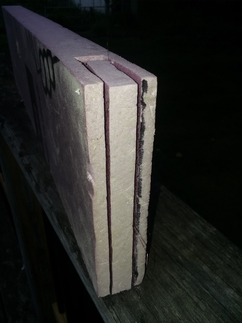

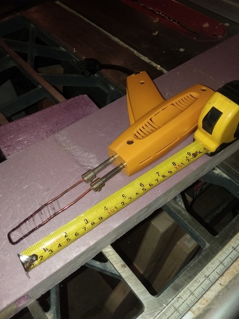

I played around with several ghcoe inspired hot wire foam cutters and after several tries with 12v wall worts and 12v battery chargers I tried an old soldering gun I hadn't used in years. The wall worts, for whatever reason, shut off power to my cutter contraptions and the vehicle 12v charger (2a/6a) cycled on and off too often to make it work reliably (I didn't know these things cycled like that).

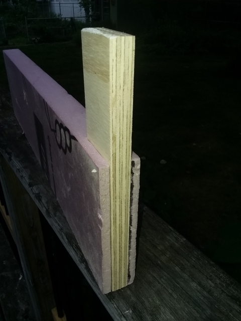

I found a youtube guy that showed how to replace the stock soldering gun tips with homemade 12g copper wire. It holds its shape well, heats quickly and I am able to turn it on and off conveniently with the trigger switch. I made a tip to cut a dado (3/4" x 4") in foam for a 3/4" plywood splice or to add reinforcement to doors, spars, bulkhead, etc.
A rough trial cut in 1 1/2" thick foam. It was easy to follow my sharpie line, but, I think I will rig up some kind of jig to guide the cut.
Even with the tip at almost 4" long it cut a nice 2 1/2" deep dado in my trial at a respectable speed.
Thanks to George and GPW for their help. Now on to designing my foam walls to floor attachment method...

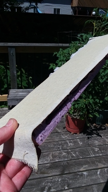

Also, I'm experimenting with TBII on untreated pink foam. I know this has probably been done a bazillion times. Its just for my satisfaction and curiosity. It definitely grips well as long as I get a good wetting on the foam prior to canvas then add more TBII to the canvas to wet it completely. I'm using the TBII as a primer as well for my first coats of paint. I like the idea of the Valspar Bonding Primer/Sealer. Not sure I need to add that step, I'm in a fairly dry climate; at least not a wet one. After it is totally dried out and has several coats of exterior paint I will submerge it and monitor it until I see separation.

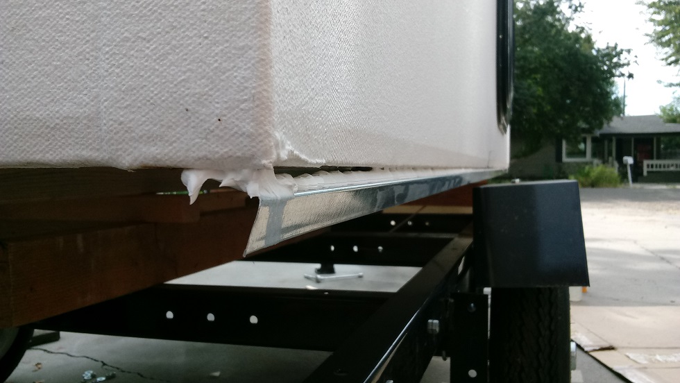

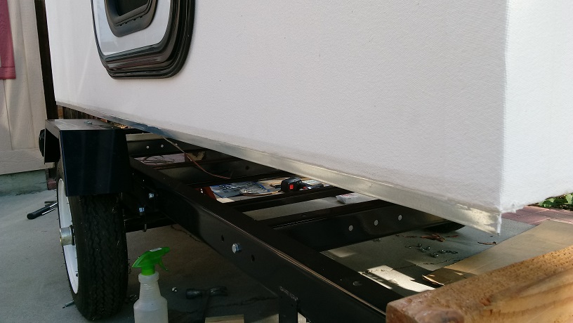

TimC wrote:George, in a past post on G Gripper and TBII and primers it was mentioned that drip edges solved some problems with standing water degrading TBII. I can picture what you are talking about, but, just want to be sure. Are you talking the bottom edges of the walls holding water, dew or condensation for extended periods after a rain or early morning drying spell? It makes perfect sense, just want to be sure I understand.
Tim
Not sure how you are going to mount your body to your trailer, but yes you should add a drip edge just in case. If you are mounting the body flush with the trailer frame I recommend raising up the body 3/4" to allow a drip edge and to keep the body and frame from rubbing on each other. I found that the canvas will rub the paint off the trailer and then I would suspect the trailer will rub a hole into the canvas exposing the wood to moisture. This area is also a moisture trap. By lifting the body up 3/4" will allow the area to dry out. If the body is overhanging the trailer then you could probably just add a drip edge around the perimeter the body.
I use drywall end edging for a drip edge. I use truss screws to screw it to the floor. Before I tighten the screws up I squirt in some Dap Latex Caulk between the edging and the body then tighten the screw. This fills in the voids and seals the screws.

Postby GPW » Sat Jul 04, 2020 4:25 am
George , we used your drip edge on the FS and it works GREAT !!! Many Thanks !!! 8) :thumbsup: :applause:
