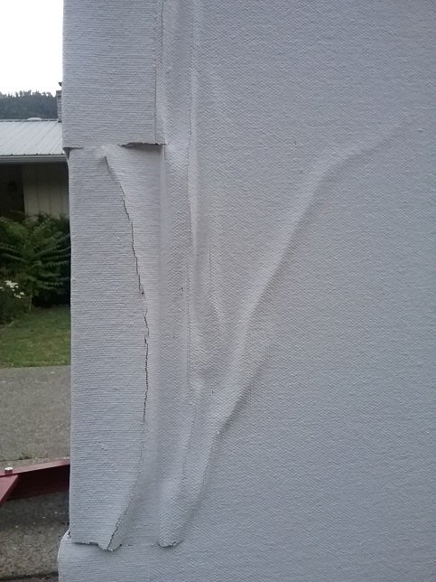

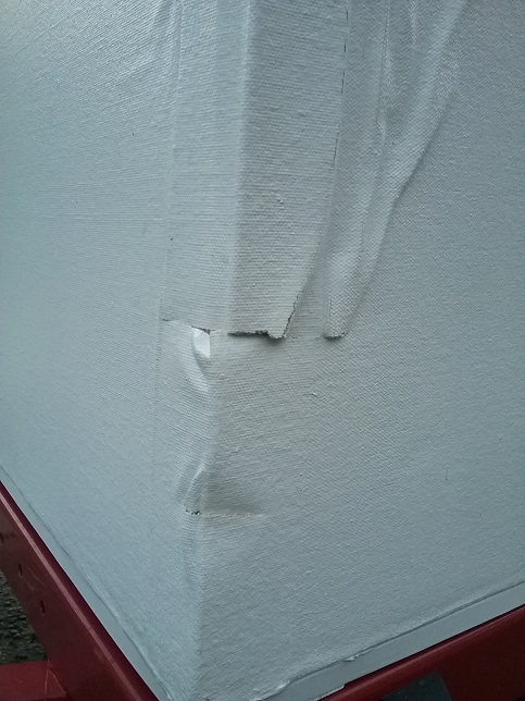

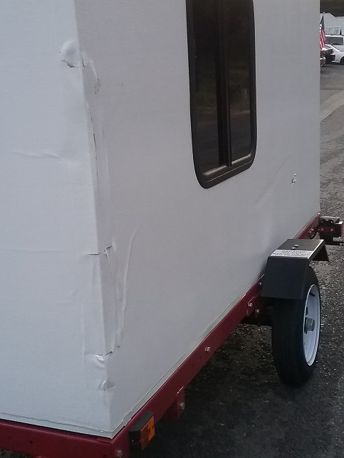

Just a FYI. The person who purchased #3 hit a deer with it at 60mph on his way back home. Taking the frozen turkey test to the next level. Luckily he missed the deer with his small pickup he was towing it with. Could have been a lot worse.
Considering this unfortunate circumstance I think the trailer faired quite well and should be repairable.

He said he he had thought he had missed the deer, but then looked in the rear view mirror. He saw a antler flying off and the deer spinning down the road from the impact. To top things off, he also lost the keys to it somewhere between here and there too.
I told him to wait a week or so and see what the foam does. He could not check the interior for damage since he lost the keys. I think, going by the pictures, it should recover pretty good. Some TB II with a syringe to re-glue the canvas down, a little caulk to fill in the tears and a coat of paint should get it looking good again or at least get it usable.

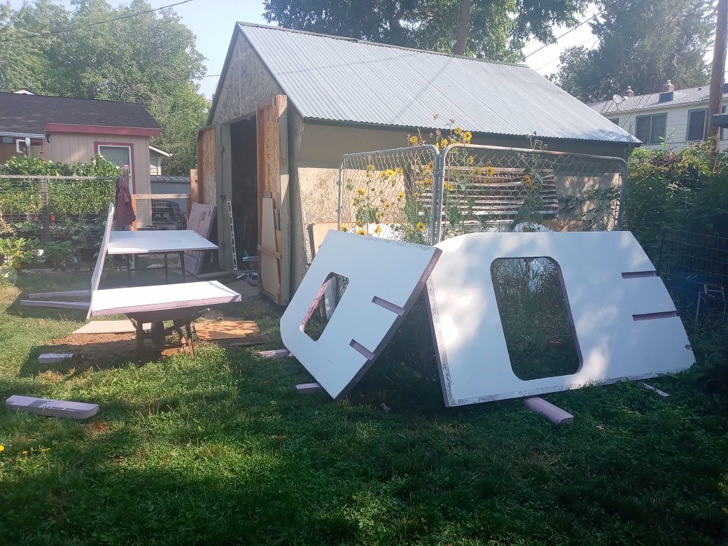

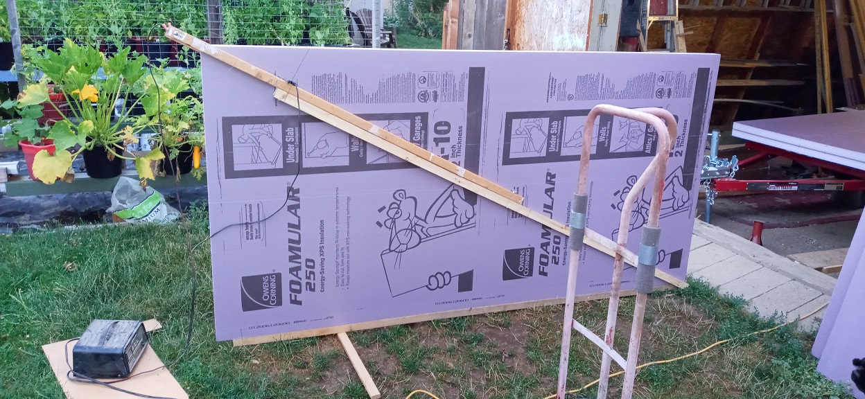

Anyway, here is a shot of the hot wire jig cutting the rear arc of the back wall.
Jig
20200727_063641 s.jpg (359.86 KiB) Viewed 3489 times
I made a jig for the window and door. The hot wire and jig makes for a nice tight fit and now no pink dust laying all over.

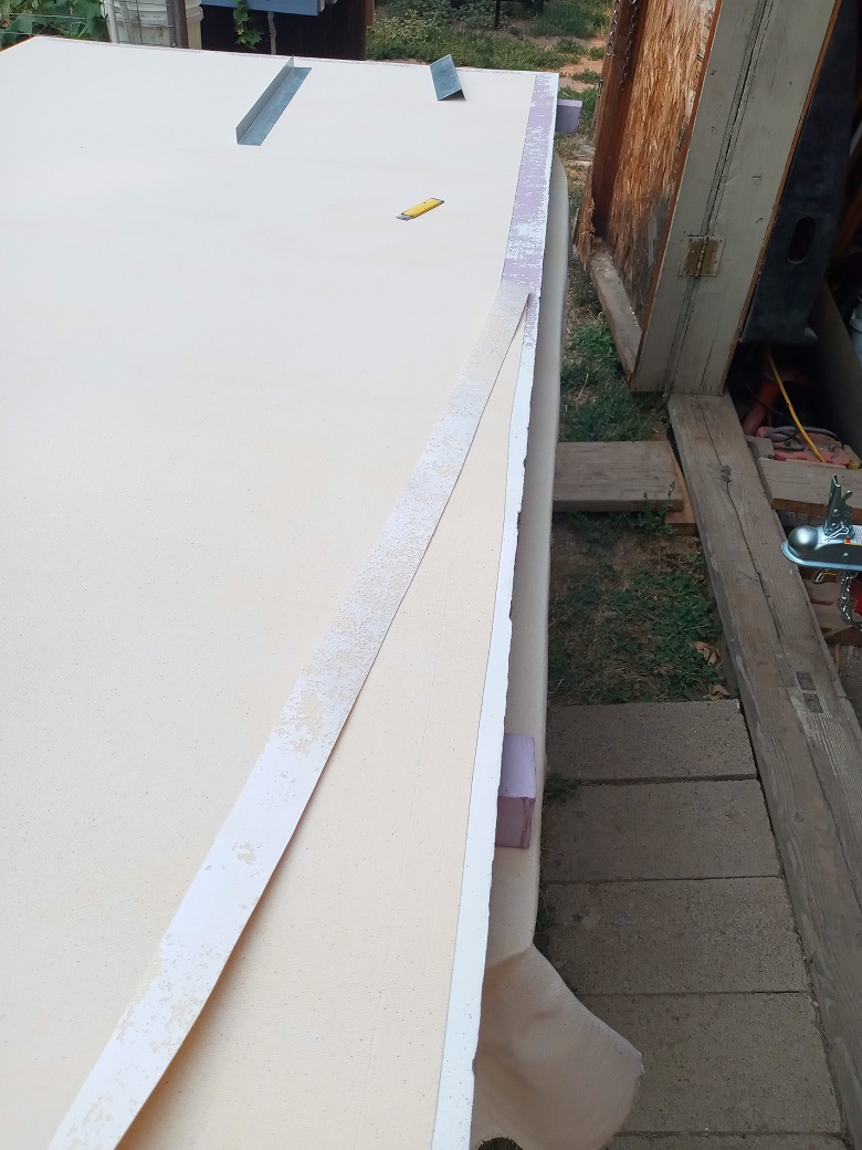

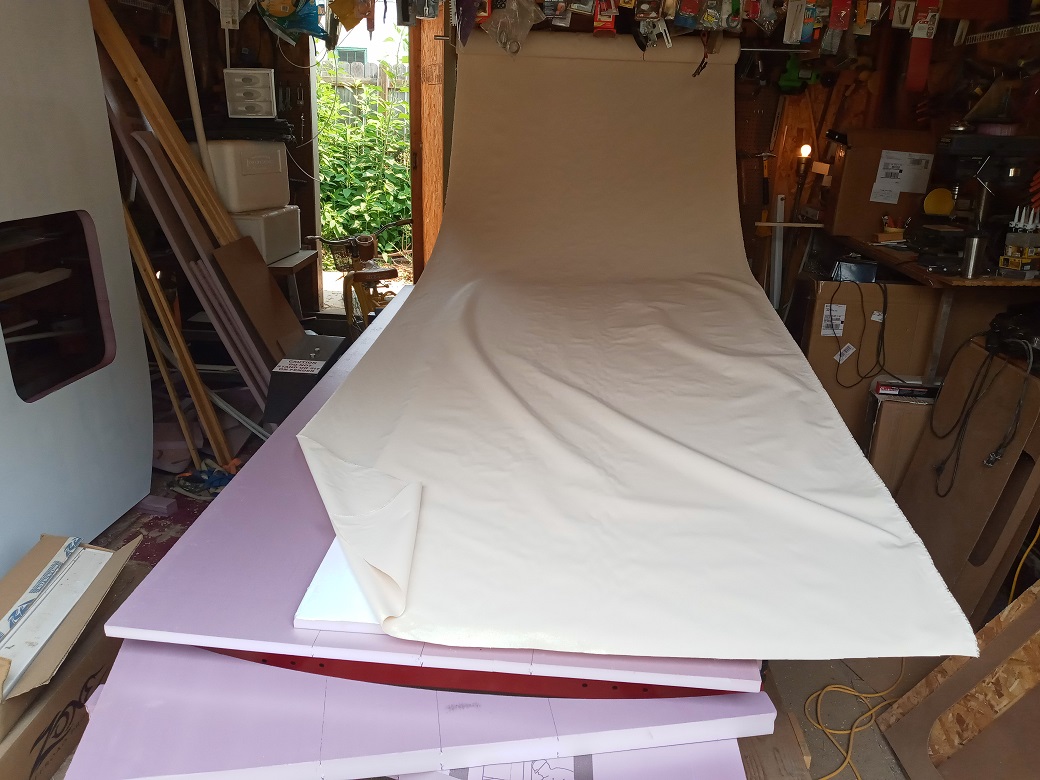

25 yards of canvas on a roll for shipped for $10.00 more the the Harbor Freight canvas. Not too bad. It has a tighter weave than the good Harbor Freight canvas that I have used.
canvas
20200821_135630 s.jpg (220.72 KiB) Viewed 3480 times

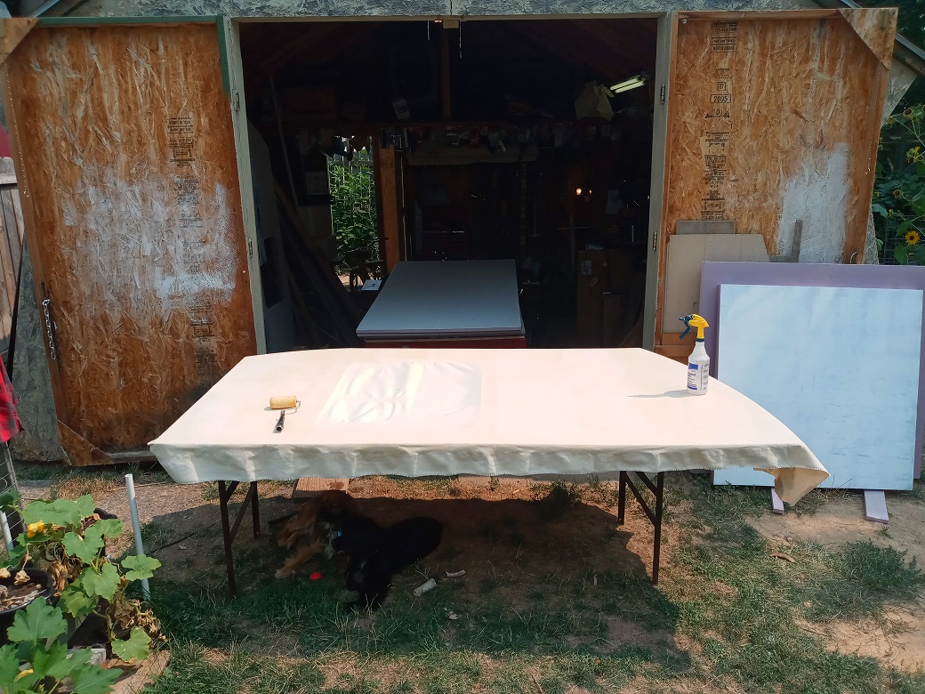

The Valspar Bonding primer seems to be working well. Here is a shot of me removing some canvas. You can see that the TBII has bonded well to the primer and the primer is peeling off foam.
primer
20200821_165455 s.jpg (221.89 KiB) Viewed 3480 times
Panels canvased and painted. I also have hotwired the dados for the shelves.

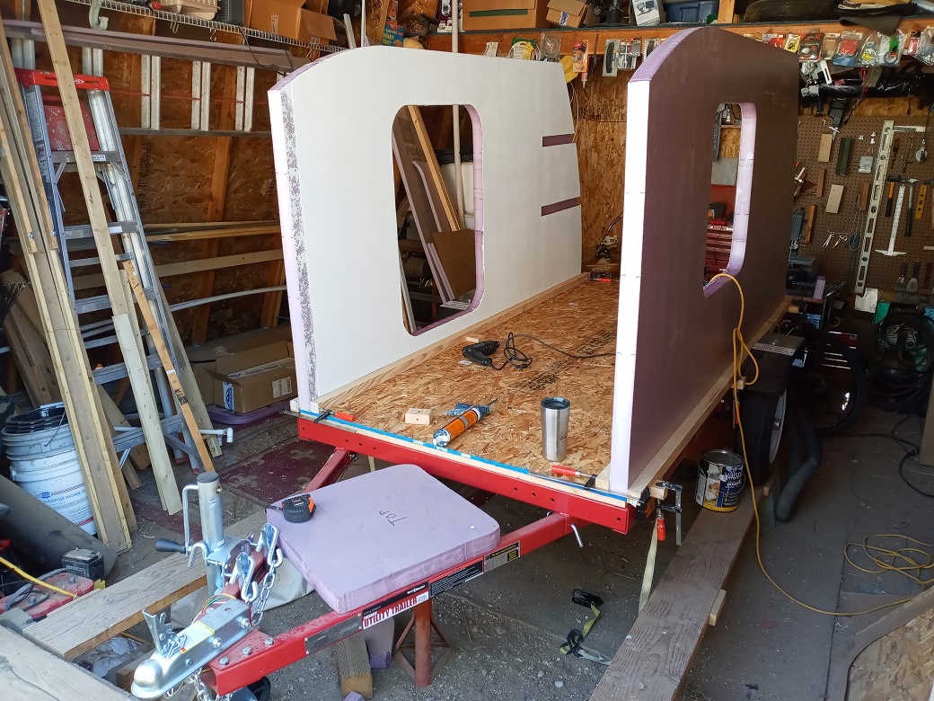

Postby ghcoe » Thu Sep 03, 2020 7:14 pm

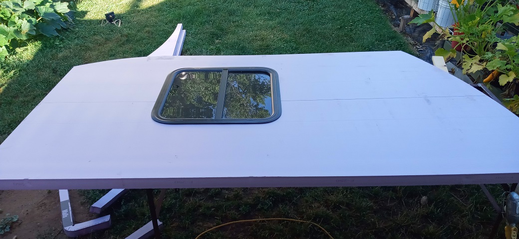

I got the walls attached last weekend. Hope to get the end walls and roof on this weekend.
walls attached
20200830_120755 s.jpg (365.75 KiB) Viewed 3485 times
