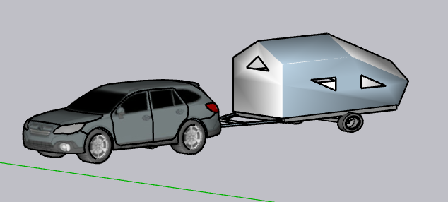

After seeing this ski trailer a couple months ago I've become obsessed with building my own ski trailer.
I then realized that copying that trailer would be: too expensive X4, too heavy X3, and not warm enough X2.
After rolling a couple designs around I've settled on building a foamie. I don't think I would begin construction until next summer and wanted to hash out some designs in the meantime
Key features:
- Enough insulation to stay warm when it's 0 degrees overnight.
- Light enough to be towed by a subaru outback (~2000 lb).
- Big/airy enough to allow climbing in wearing ski gear, not getting the bed wet, and clothes drying overnight.
- Wind shedding enough to not toss me off an icy, winding mountain road.
- overall be able to handle several days in snow.
I really wanted a standy, but at 6'5 in ski boots my first drafts were all too big for wind shedding. I went way smaller trying to hit the 4x8 trailer frame size but it was going to be too hard to keep everything dry.
I settled on something in the neighborhood of 6x12 footprint. crawl in / slouch height, about 50/50 bed and flooring.

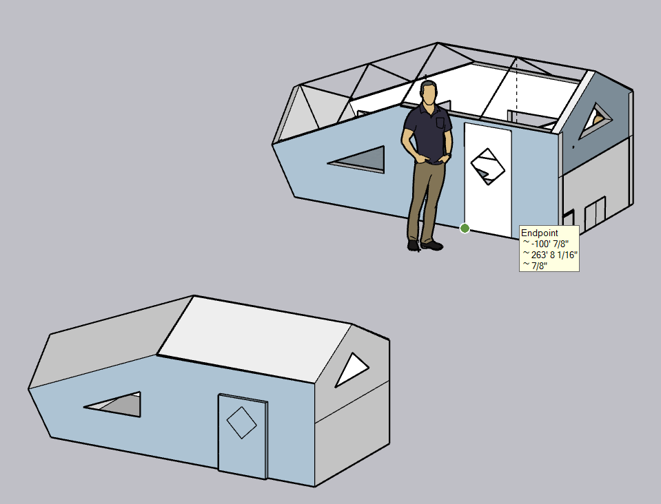

Screenshot (86).png (37.92 KiB) Viewed 2956 times
I think the walls will be either 3 inch XPS or two layers of 2 inch XPS glued together to make 4 inch walls. (I can't seem to find a source for the 3 inch foam in the state of oregon). Additional rigidity will be provided by OSB ribs running as arches up the sides and through the roof. Windows will not open, but be hand-built double pane acrylic windows following this construction style. with dry outside air instead being provided by dry vents cut into the walls with computer fans.
I went with a gable roof to shed wind and snow, which I'd never seen before. Maybe it won't shed as much crosswind as I think. I'm a little concerned about the roof seams leaking longterm ( but this should should not see prolonged rain, only snow). I was originally planning a PMF skin but concern for the roof seams is making me reconsider fiberglass.
There will be no plumbing at all, maybe a composting toilet or maybe nothing but a bag.
in terms of power, It seems like solar is out of the question most of the time and instead I should just rely on significant battery banks for my primary power. This would only be for charging phones and other gadgets, and powering a heater. I'm considering not even wiring lights and using a combination of lanterns and battery power stick on lights in key locations.
Cooking would probably just be a single burner camp stove (and maybe 12v electric kettle for a cup of cofee in the morning).
For heat I expect a sealed/vented propane or diesel heater (I wish there was a discount propex available like there seems to be for diesel).
Am I on the right track?

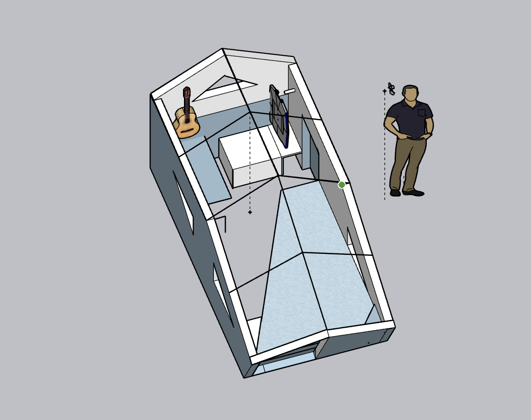

Screenshot (84).png (157.33 KiB) Viewed 2956 times

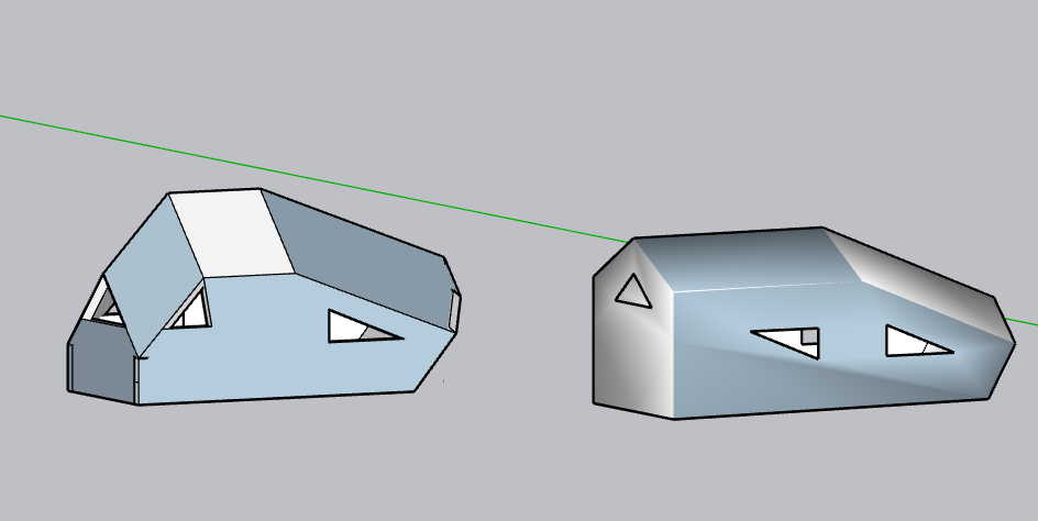

Couple things: Slope that front triangle for a little better aerodynamics.
I drew a couple designs like that, but it really cuts down on the interior volume while really increasing the number of roof seams and bizarre faceted edges I have to match up.
It may be necessary though, I defer to the community wisdom.
Screenshot (82).png (41.59 KiB) Viewed 2783 times
I try to make up some of the lost height by increasing the peak roof height but then I started to worry more about crosswinds.
It's also hard to figure out the interior layout that still gives me a bench seat right inside the door to sit on to take my snowy boots off.

Postby Pmullen503 » Fri Sep 11, 2020 12:40 pm
I was thinking that just the triangle bit at the roof could be angled back, the side walls would not change. The main part of the body runs in the wind "shadow" of the tow vehicle so it's not necessary to streamline the front all the way down to the frame. Another case of diminishing returns.
