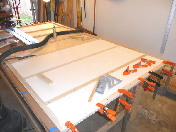

Like others have done, I used 1x2 framing with 1/4" plywood (actually 6mm Baltic/Russian Birch plywood) top and bottom with the voids insulated:
With framing on in the floor, you can eliminate almost all of your transverse metal framing in your trailer to save weight.
To further save weight, you could reduce the size of the 1/2 framing to say 3/4" thickness x 1" width and, if you don't go rock-crawling and protect the floor during the build, I feel you could use 3mm Baltic/Russian birch plywood instead of the 1/4"/6mm.
Aggie:
I think you were the one that tipped the scales for my last floor construction. :thumbsup:
