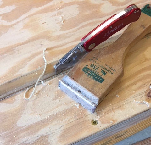

the above mentioned use of a box knife heped me remove the ooze of PL-Premium
i also sharpen a house painter's scraper to a wicked sharp edge to aid in corners

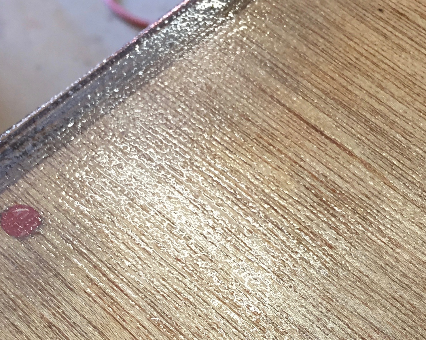

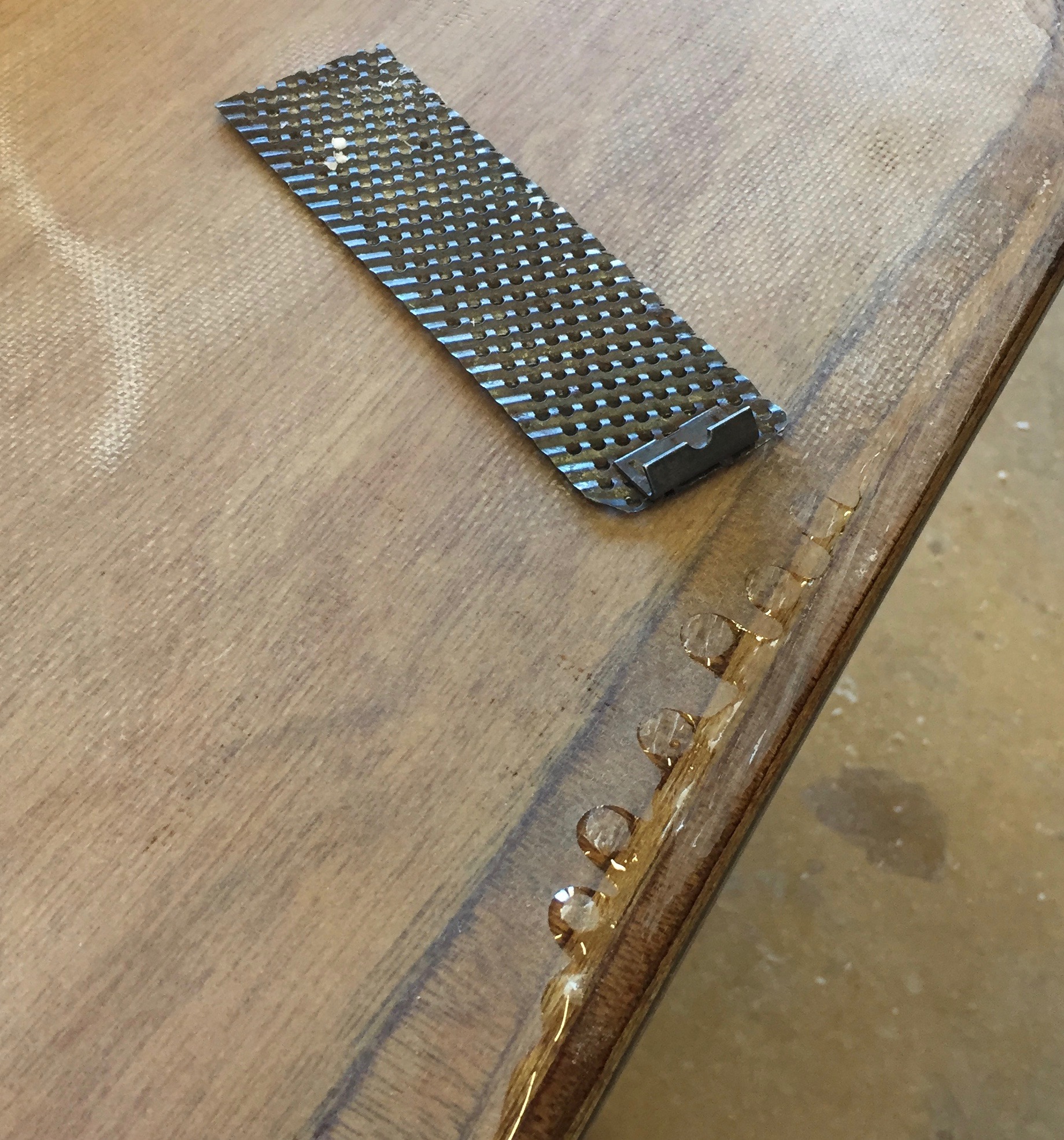

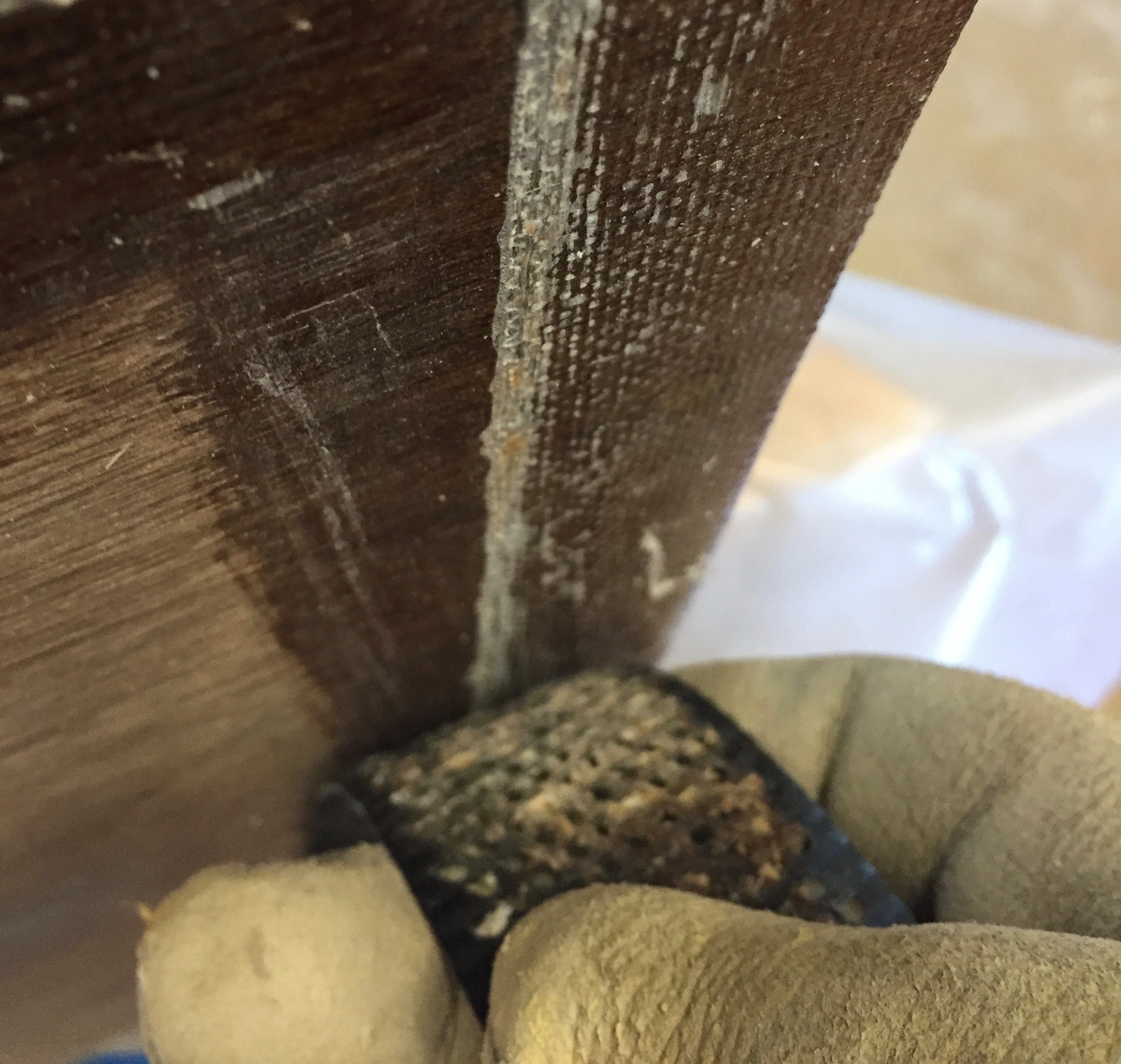

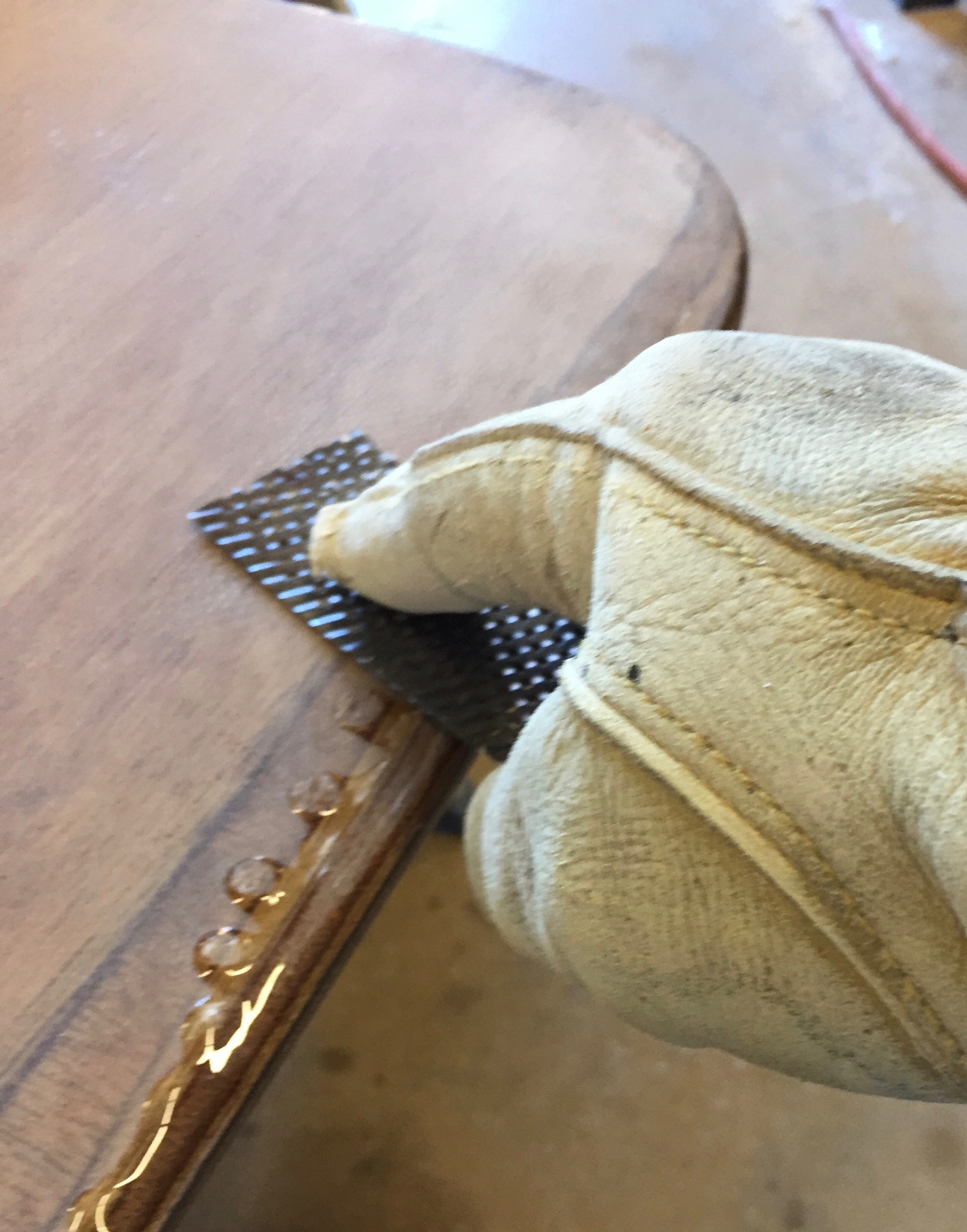

a technique i've just started using w/ epoxy/glass builds which is "so far" proving quite satisfactory involves taking the blade from a cabbage file (Sure-Form) and dragging across flat surfaces that need fairing
i wear elk skin gloves for this process to protect me pingers frum the file AND tee-tiny glass fibers

wearing elk skin gloves during this and other sanding/grinding processes aid in the prevention of self destruction(i don't heal as fast as i used2did)
this process works well on ruff fiberglass edges also
removing ruff edges a/o ooze n drools w/ the cabbage file makes smoothing surfaces much easier to sand n finish
cabbage file for flats and the 911 hijacker's weapon n sharpened scraper for corners are my current goto tools for removing extraneous farfelonus ;-)
