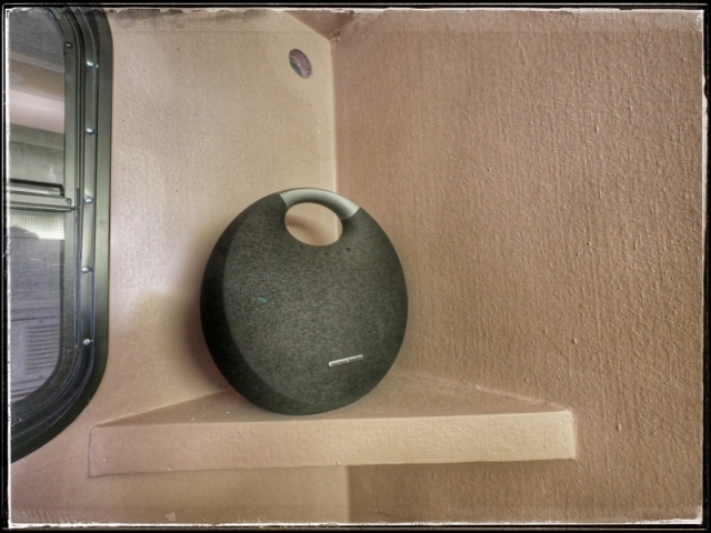

I think gorilla gluing the shelves should work fine. If you need the shelves to have more strength, wood glue window screen to the bottoms of the shelves, before canvassing them.
The screen, wood glued on, causes the foam to be extremely rigid and strong, while remaining very light weight.
My "corner shelves" are screened underneath and are very strong:

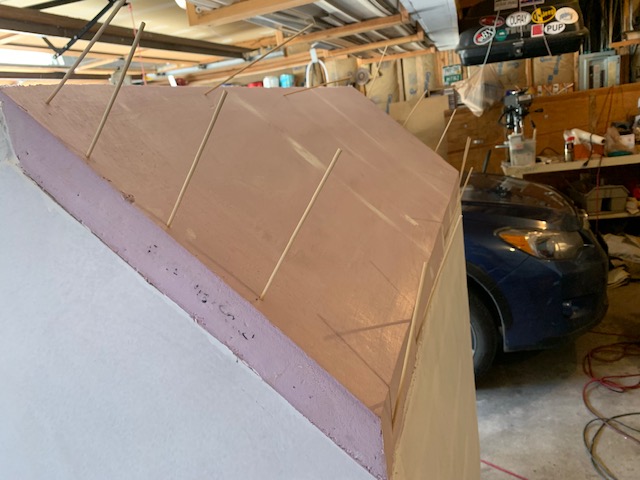

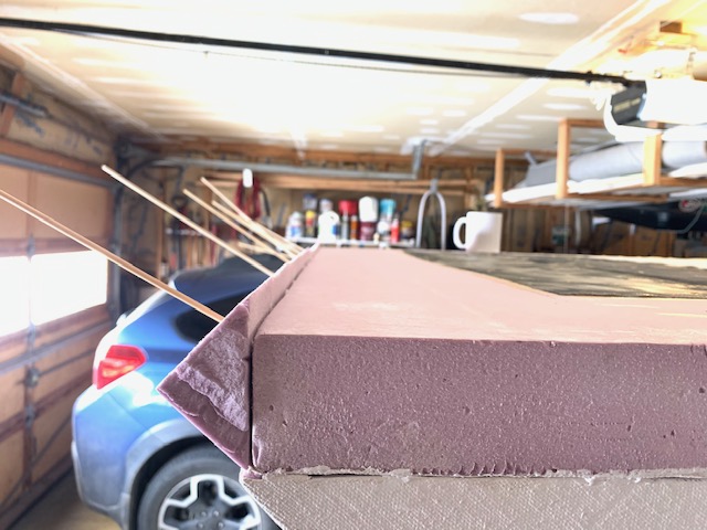

I doubt many of us were born with three or four extra hands. If you don't have help during assembly, you can use as many wooden kabob skewers as you like to hold the foam panels together during assembly. Whatever holes are left behind will be covered by canvas anyway.

I've done the skewer method but the skewers end up securely glued into place and I can't pull them back out. Which is fine, I just cut them off flush and canvas over them.
Curious about different ways to clamp already canvased large pieces together, since skewers aren't sharp/small/ridged enough to push through canvas. I'm completely encapsulating the interior walls and shelves with canvas in order to then glue them into place, canvas to canvas, and then I plan to use a strip of canvas over the inside corners, like a filet weld. Should be very, very strong. I'm thinking that using gorilla glue would be the way to go, as the inner walls and shelves are already interlocked inside the outer walls. So all I would need to do is make sure they stay in place while the glue sets- the expanding glue would only push against itself and fill any gaps with ratchet straps around the outside to keep the outer walls from being bowed out.
