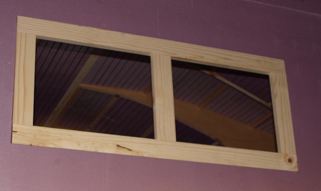

I may be too late here, but I made my frames from 1x3 (so 3/4" x 2.5") pine and used a hot-wire jig to inlay them into the 2" foam so that they were flush with the outside.
Day 46d copy.JPG (52.07 KiB) Viewed 1996 times
I used a pocket-hole jig/screws to hold them together.

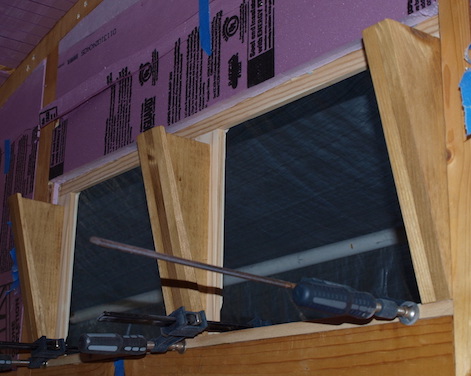

From there I built the Wiley frames.
Day 70c copy.JPG (63.14 KiB) Viewed 1996 times
I was interested in the Wiley windows because I hadn't heard of them until I found them here and thought that being able to leave them open in wet weather was cool, but they're kind of a pain in reality. Without screens, the wedges are in danger of falling out when messing with them, and it's quite a process to open and shut them, but I'll probably add another to the trolley top in the rear anyway.
