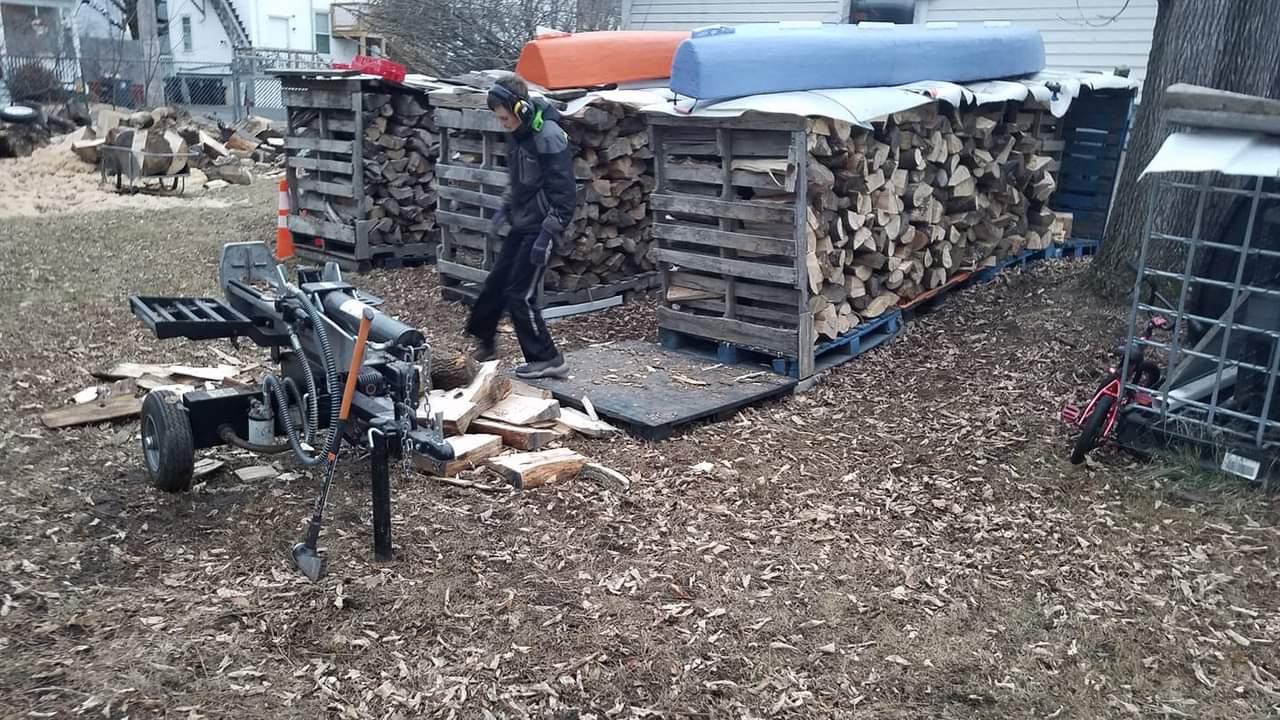

Postby rowerwet » Wed Jan 20, 2021 9:23 am
GPW wrote:Now then , as far as the long term cost goes , we’re going on out Eighth year of the Foam Stream living totally outside , and through all kinds of nasty weather and storms … The results … It got dirty … :o With a good Wash and chasing the little critters out of the door areas , we’re ready to go … And yes, the fully surrounding drip edges really DO make a difference !!! ( Thanks to George for that!!! 8) )
Same here, my foamie is also full time outside and essentially ignored. Rain, sun, ice, snow, my kids climbing on it to sit on the roof, it's unchanged. Same with my foam kayak fleet. I normally store them outside year round, on top of my firewood racks. They get beat up from use, but not from sitting out exposed.
Fiberglass needs a UV barrier, and that often needs maintenance, house paint makers put plenty of research into that already.
