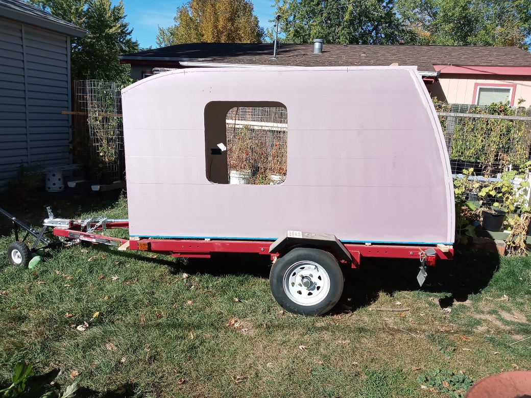

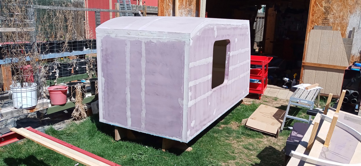

I am working on a more rounded Bug Out right now. I prepped it for canvasing today and thought I would weigh the body before I canvased it. It came in at 91lbs. I use manufactured doors that come in around 30lbs and windows that come in around 10lbs. Harbor Freight trailer is 253lbs that comes in at 384lbs before exterior paint and canvas. My #2 build came in at 371 so my numbers might be off a bit on the doors and windows, but still should be well under 400lbs. If weight is of upmost importance you can purchase a Northern Tool aluminum trailer. They shave another 60lbs. off the trailer weight. Cost a bit more though.
Drag would depend on what you are driving. If the roof lines are close you probably would not notice much. The lower the tow vehicle is to the roof height of the trailer the more drag you will notice.
Good luck! George.
20201016_150131 s.jpg (449.37 KiB) Viewed 2362 times
20210417_145716 s.jpg (626.41 KiB) Viewed 2362 times

Postby ghcoe » Mon Apr 19, 2021 7:36 am
YannG wrote:
ghcoe wrote:Good info. Much lighter than I thought. What type of construction you choose for your floor? Also, for the curve on the roof, did you use 2 sheets of thinner foam for ease of shaping or you did the kerfing?
I use OSB for the floor. I do install what I call inner frame rails and floor spacers.
The inner frame rails disperse the floor loads along the wall better and hold the wall in position as well. It basically looks like floor board along the walls like you would see in a house.
The floor spacers raise the floor off the frame 3/4". This allows room for the drip edge and keeps the trailer frame and foamie body from rubbing together. Also, it avoids a moisture trap between the body and frame.
I did use two 1" foam panels to make the curves. Even with the slight curves there is still a lot of tension. This was a experiment to see if I could get away without kerfing to save time. Although I did get it to work I do plan to kerf the next build since it is a bit of work to keep the glue ups from coming apart.
I will do it like I did on #1. Kerf the bottom of the top sheet and the top of the bottom sheet. This way you don't have kerf lines to fill and smooth out.
George.

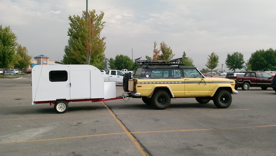

I did a 2 foot radius on my #1 Build. You will need to kerf on that sharp of a radius. You can read about how I did it starting near the bottom of this page viewtopic.php?f=55&t=54099&start=90 . You might want to read through the whole thread to get some ideas on other build techniques.
I built the doors on #1. They work, but for the time and effort I spent trying to make them work, and not the greatest at that, it was nearly a bust compared to a manufactured door. Don't think of it as just a door though, it does have a window so you are killing two birds with one stone.
#1
20170908_093558 s.jpg (270.86 KiB) Viewed 2240 times
