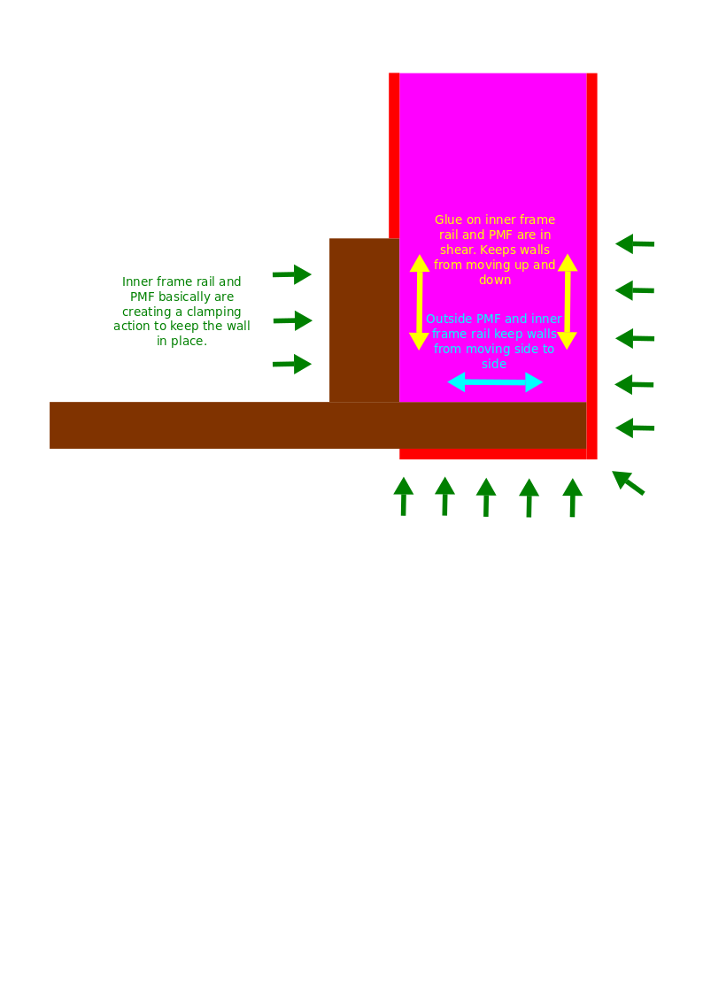

Postby ghcoe » Mon Aug 30, 2021 5:16 pm
No need for reinforcement as long as you wrap the canvas properly.
I use what I call inner frame rails to help attach the walls to the floor. These frame rails keep the walls from being pushed in. The canvas keeps the walls from being pushed out or up. The rails also help keep the floor from flexing next to the wall on the interior. This flexing can cause delamination of the floor to wall glue up.

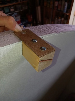

If you are going over 4' wide I would consider some sort of extra roof support. I usually use 2"x2" embedded into the walls that the roof will rest on once installed. Easy to do.
Make a simple template to know where to cut.

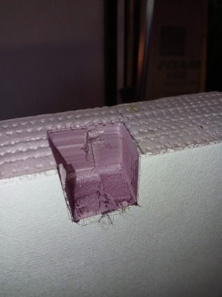

Cut back into the wall far enough so the 2"x2" has enough support from the walls.

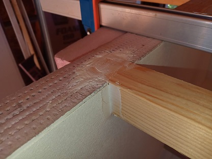

Postby ghcoe » Mon Aug 30, 2021 5:22 pm
Then I use Dap Caulking to embed the 2"x2" into the wall.

Postby ghcoe » Mon Aug 30, 2021 10:03 pm
pchast wrote:Neat work. How did you cut the pocket there?
I used a box cutter to cut the canvas first and then I used a trigger style soldering gun with a modified tip to cut out the foam.
