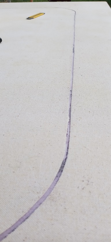

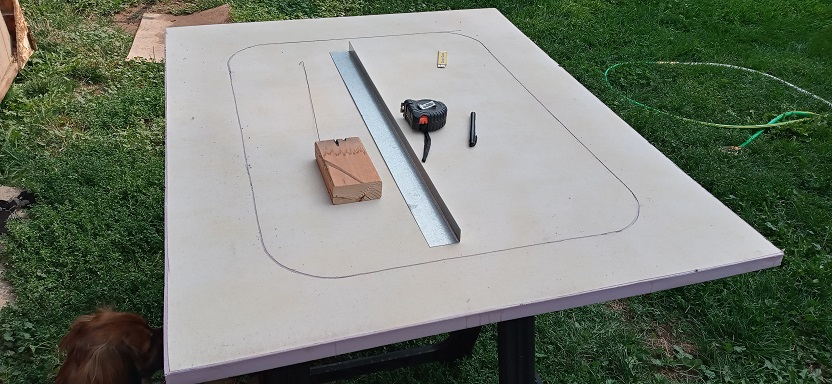

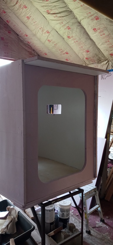

Postby ghcoe » Thu Sep 16, 2021 5:23 pm
I have made cut outs on walls that were already PMF'd on one side and both sides. Here is a door I cut out recently.
#1
20210821_164728_HDR s.jpg (401.83 KiB) Viewed 792 times
#2
20210821_164734 s.jpg (339.83 KiB) Viewed 792 times
#3
20210823_122607 s.jpg (354.78 KiB) Viewed 792 times
Just make sure you cut out the pattern correctly or you may have some issues.
