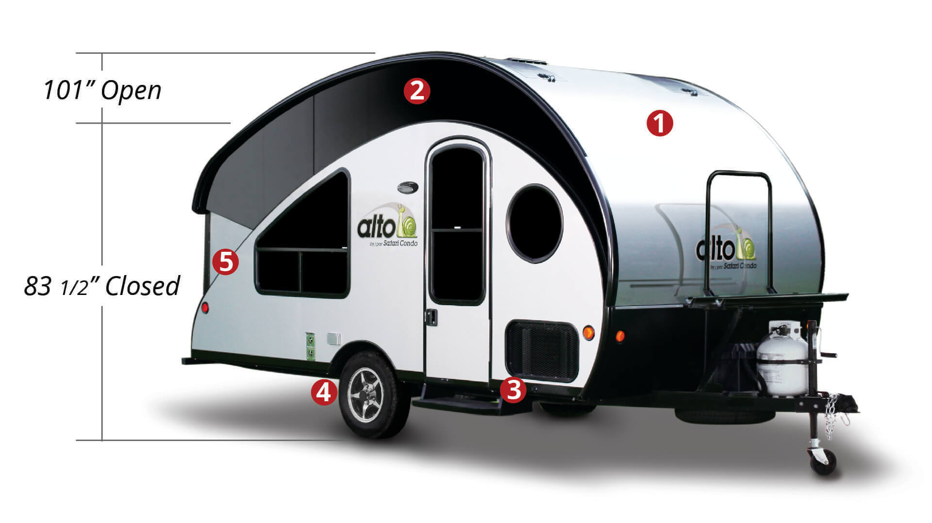

There's a company making lifting roof teardrops that looks so much more comfortable to stay in, called Alto by SafariCondo. I really want to try to use the lifting system of the popup to lift the roof. Any advice is appreciated, including not doing it for reasons of water, etc. I'll try to attach a picture.
I've tried Sketchup and just can't seem to get the hang of it, so if anyone has a teardrop pattern that we can scale it would be great! Also, I've seen what water can do to all your hard work and don't want to put in a sink. The trailer has the water tank left, maybe I could see leaving it in place, but I don't plan to put in a sink in the galley. We mostly stay in State Parks here in Texas, and use sites with running water.
