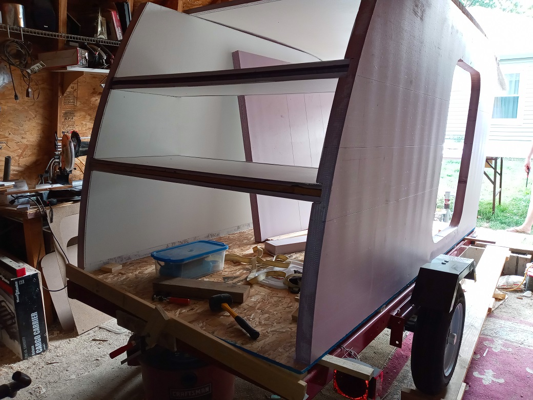

I use dado's to install shelves and bulkheads. I use a hot wire.

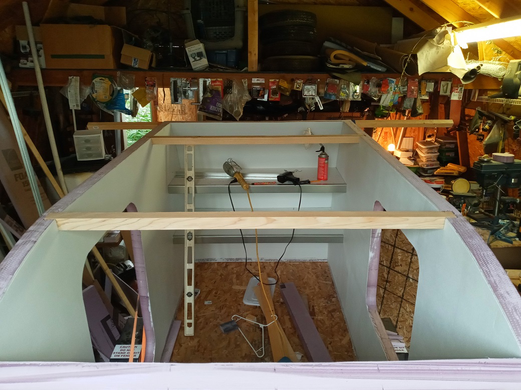

Also, I would not run the rafters all the way to the outside like he did. I would make pockets like I did on this build. Wood and foam have a much different expansion and contraction value and any wood exposed will telegraph through the canvas.

Of course this would also include how he did his windows. I would stay away from making the hard points like he did. Wood exposed like that will telegraph though the canvas.
I saw those pocket cuts you did George with the hot wire and your point about exposed wood to PMF might migrate through the canvas. So, you’d do the same with hard points and recess them into the foam but not through it? How does that work on window and door openings where wood framing is installed that eventually gets wrapped with canvas too?
